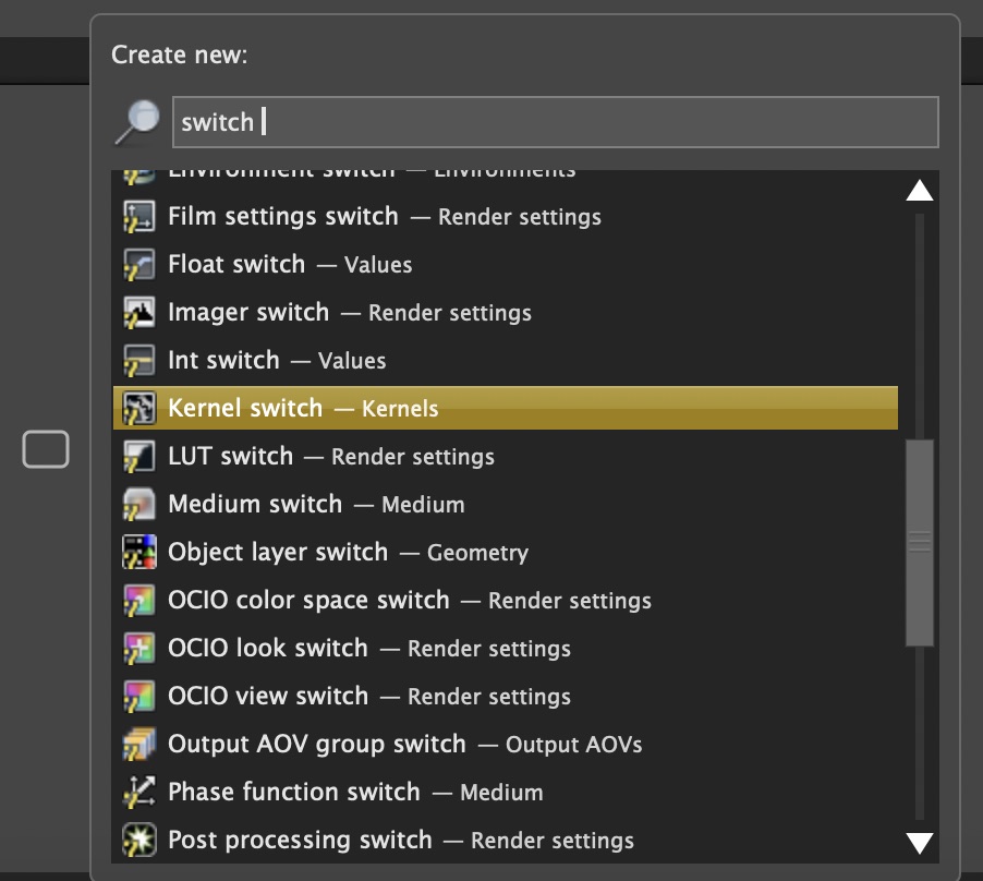

face_off
Posts: 15756
Location: Adelaide, Australia
Apologies for the late reply - I missed the email notification.
Yes, Kernel Switch would solve this. However the switch nodes are implemented in Octane in a fashion which is not compatible to the plugin, so unfortunately they are not supported.
Paul
