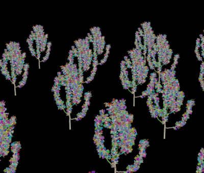

Here's my demo scene:
https://1drv.ms/u/s!AiO-yRNxbYloggPeZ28 ... M?e=cxfrSt
The most basic thing would be: I have a tree with a Cd-attribute
and then I instance it.
Can I get that color attribute to render?
My case would be then to have a random color per instance, which is working right now through that instanceTexture-workaround but also to use the instance's point colors. If I do the same without packing, I can for example call the point color Cd2 and the one per copy Cd and use both in my shader. This is what I would want but with packing.
Cheers

Hmm, nope, I think that something like that is not possible right now. We only support one "Cd" attribute in the instances. The plugin supports nested instancing, you can instance an instancer, but I'm not sure if this is going to help with the double Cd attribute.

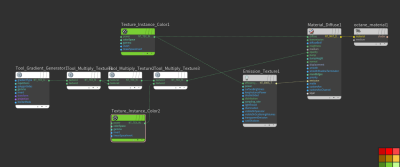

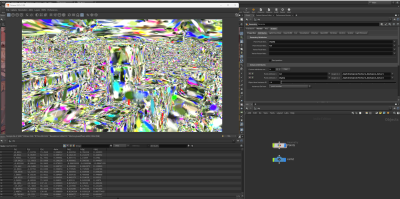

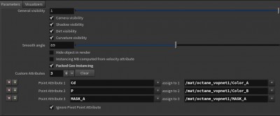

Hi, im trying to transfear an alpha+color attribute to material, but i can't make it work. Packed Geo instancing is emabled in the GEO node->Octane->Properties. When i use "Instance id from point number" and add custom point attributes it seems to change something both in Cd data and Alpha, but it looks random. When i use "Instance id from packed RGBA" the colors looks as propper Cd atts, but i have alpha always as white and it seems like custom point attributes do not doing nothing at all. Am i doing something wrong?
Sorry for the delayed response.
Basically at the moment only the instance ids from point numbers supports custom attributes.
Hoping to change that in the future but that's how it is for the time being
