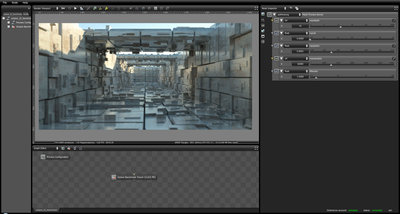

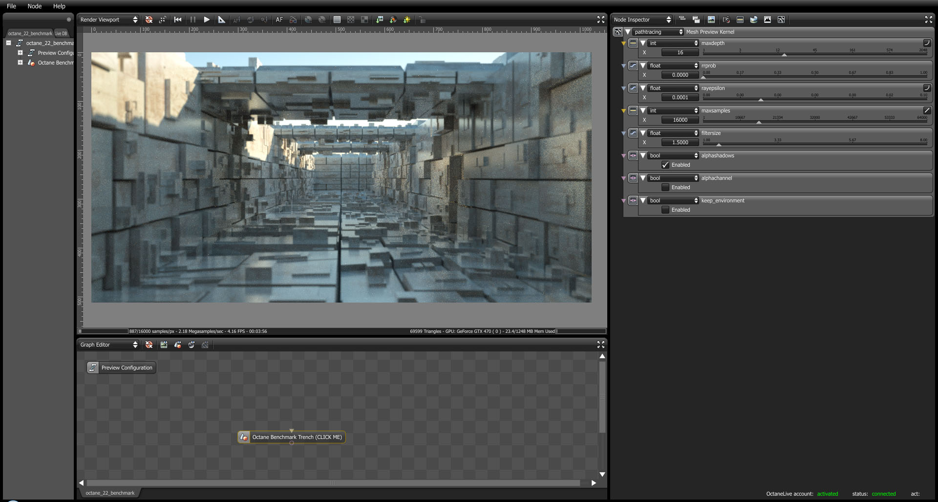

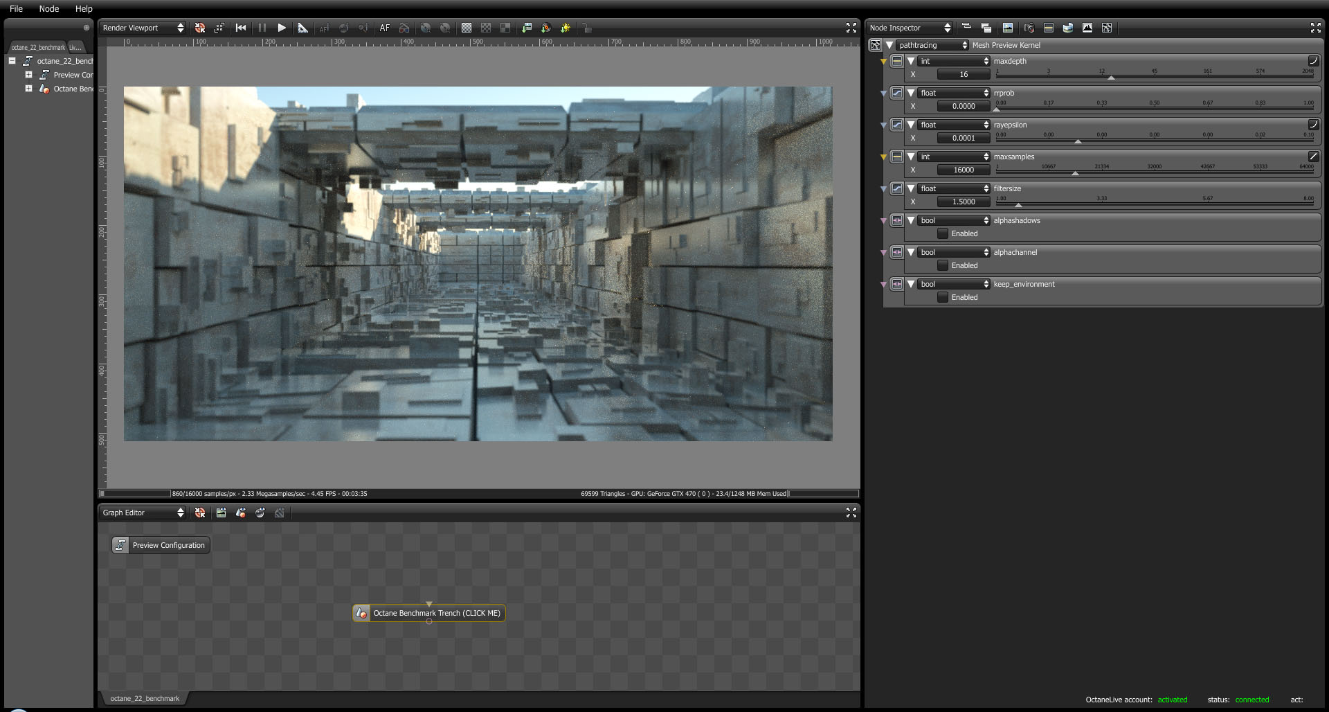

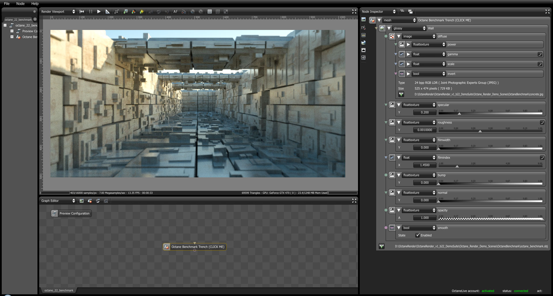

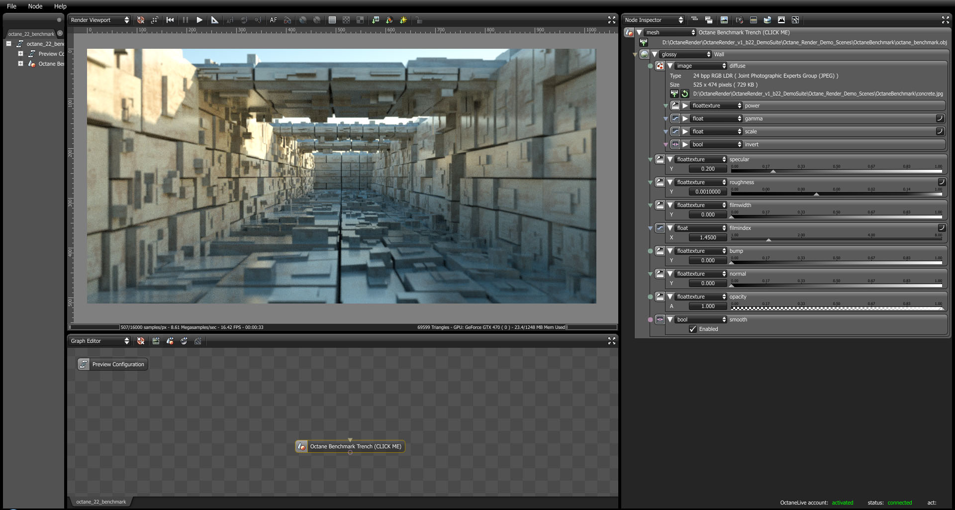

Here are some tests..
And yes there is a speed improvement
scene from OctaneBenchmark with pre23_5
scene from OctaneBenchmark with pre24_1
Dual Xeon E5540 CPU 2.53 - 1x GTX470 - win7 64 -12GB ram

**STK** wrote:Here are some tests..
alpha shadows off ?

Yes. I just open the OctaneBenchmark scene and hit render
