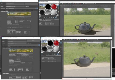

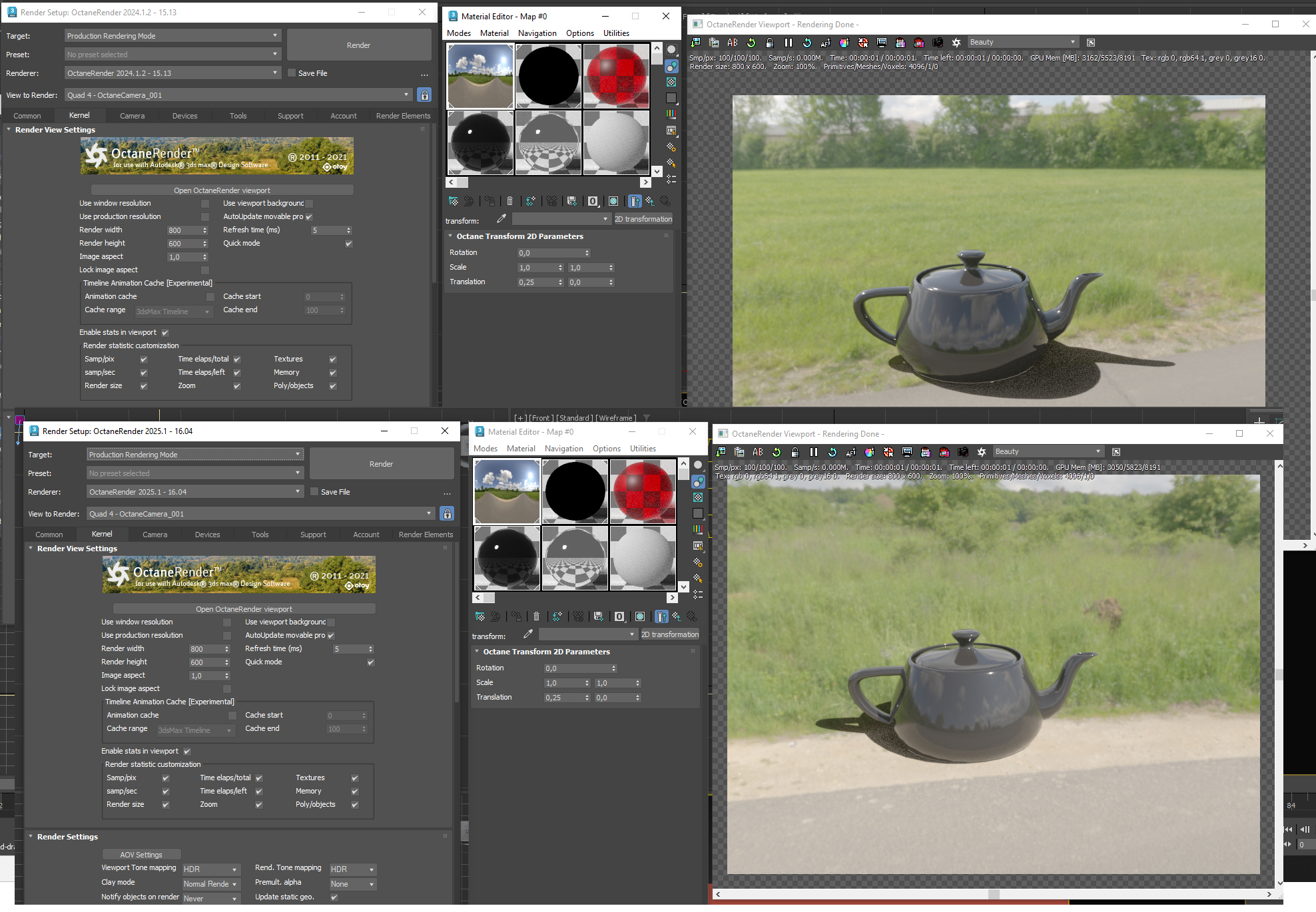

mbetke wrote: Wed Apr 09, 2025 10:52 am Are there changes in texture environment 2D transform angles with this version?
I had several old scenes with latest version before 2024.1.2 with a complete different sun angle now.
Usually I use a Texture-Environment with a RGB Image (HDR). I use the UV transform slot and apply an 2D Transformation with a value for example 0,25 and 0,0.
With current version, the 0,25 is now exactly 180° wrong. So to get my old 0,25 I need to enter 0,75.
This happens to all of my scenes. And I use a lot of recent scenes from many years.

Hi mbetke,
Thanks for reporting this issue.
The Mesh UV projection has changed between version 2024 and 2025 : the clockwise rotation is inverted..
There is a Compatibility mode for that, and loading an old scene with this projection will use the correct 2024 compatibility mode..
The problem in you case is probably that there is no projection set.. so the engine use an internal default, witch is mesh UV, but it uses the current compatibility mode..
The solution is to set a UV projection manually for those old scenes, and make sure to set the compatibility mode to 2024...
This should be fixed in the next release, those projections will be created and setup correctly automatically when loading an old scene..

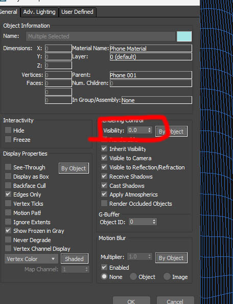

Animated visibility is not working with octane

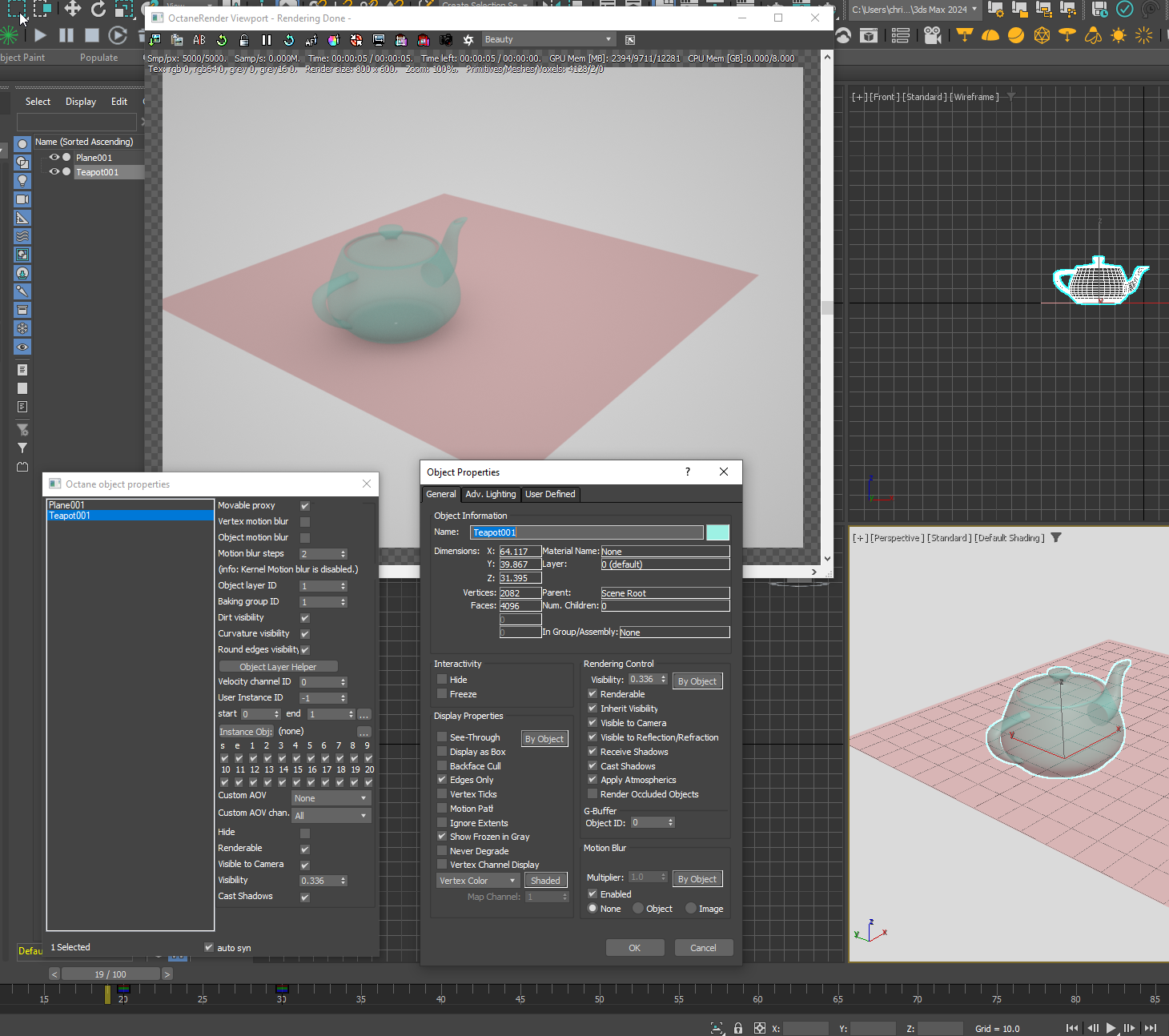

coilbook wrote: Tue Apr 15, 2025 12:50 am Animated visibility is not working with octane
Hi coilbook,
It seems to work fine.
(There seems to be an display update issue in the Octane object properties dialog, but clicking in the object in the list fixes this issue)
Note that you can see and edit some of those 3ds parameter in the Octane properties when you enable 'Show 3dsMax object properties.." in the context menu in the Octane object list .
As for the animation and render, it looks fine:
Try to reset Octane preferences if this scene doesn't work for you .. there could be some special settings activated .. ?
