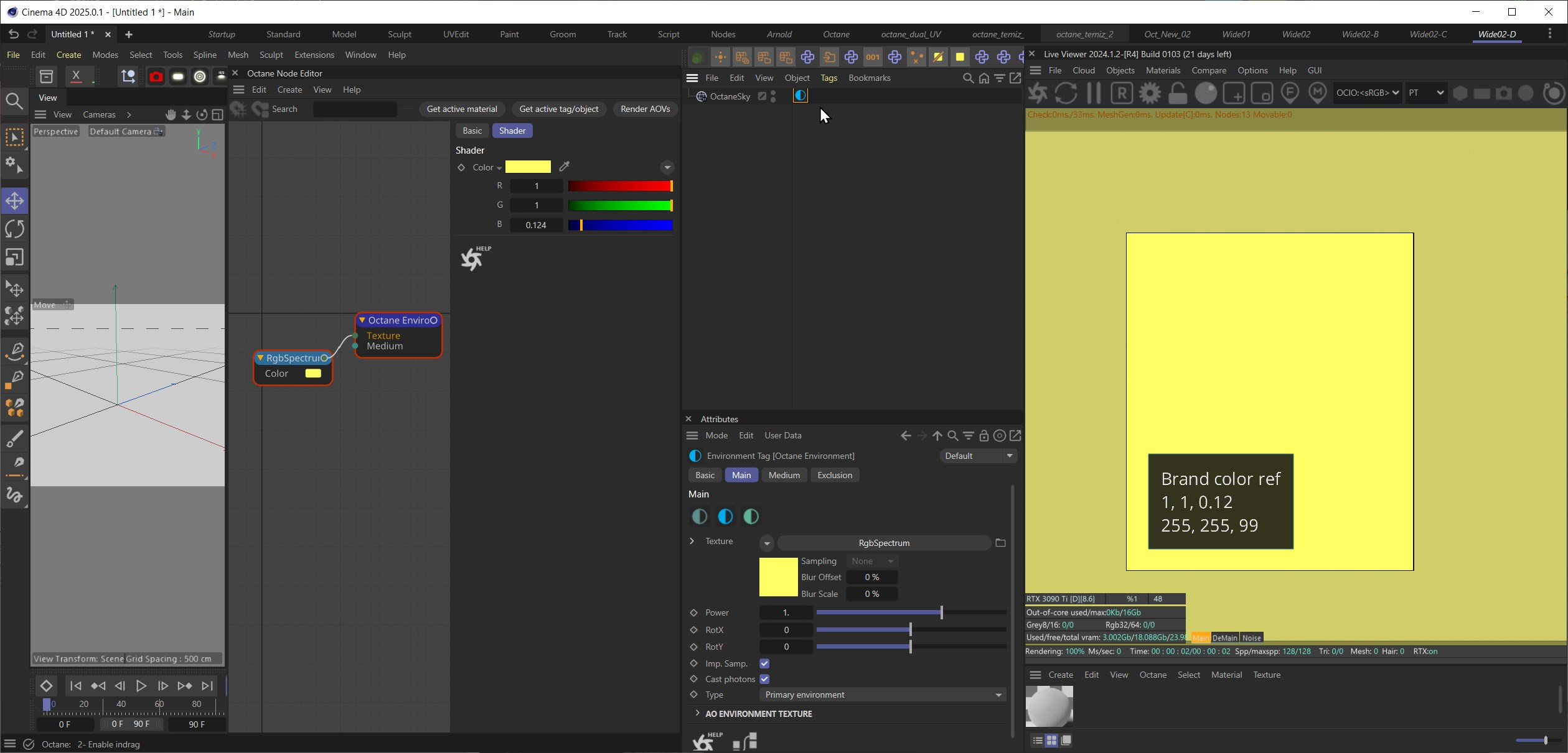

Thanks skientia,
you can see IPR and above that reference color.
