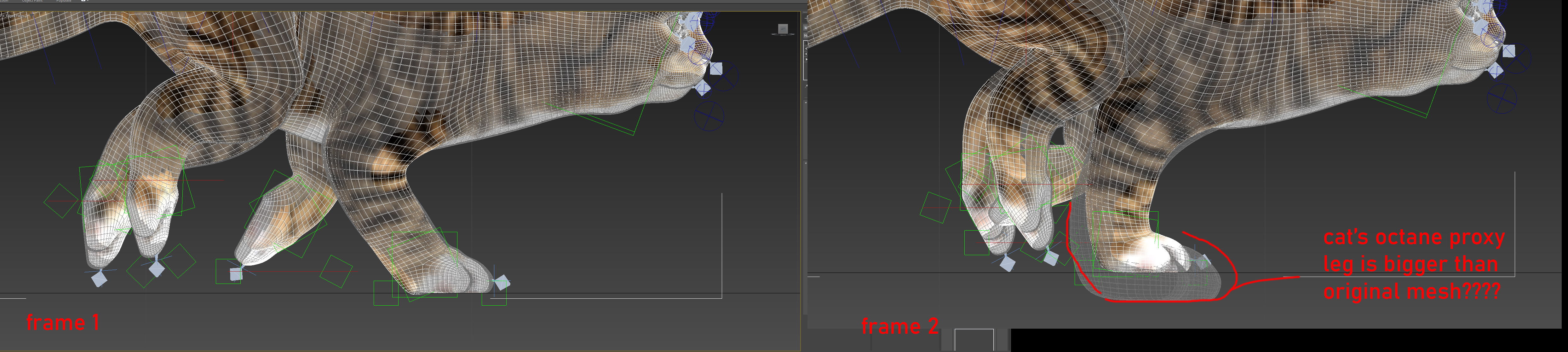

Why isn't octane proxy 100% accurate to the original mesh? When animated cat's skin gets exported to octane proxy, one leg is bigger than the original mesh. It only happens to one leg and in two frames out of 20 frames of cat run cycle.
More likely octane proxy is not exporting all skin data for that frame and that particular leg. I've never seen anything like this before Thank you

coilbook wrote:Hi Paride,
Hi coilbook,
Could you share the scene (im DM if you want) where you encounter this issue?

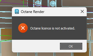

Hi. We get this error once a day and 3ds max must be restarted. Internet is always on.
