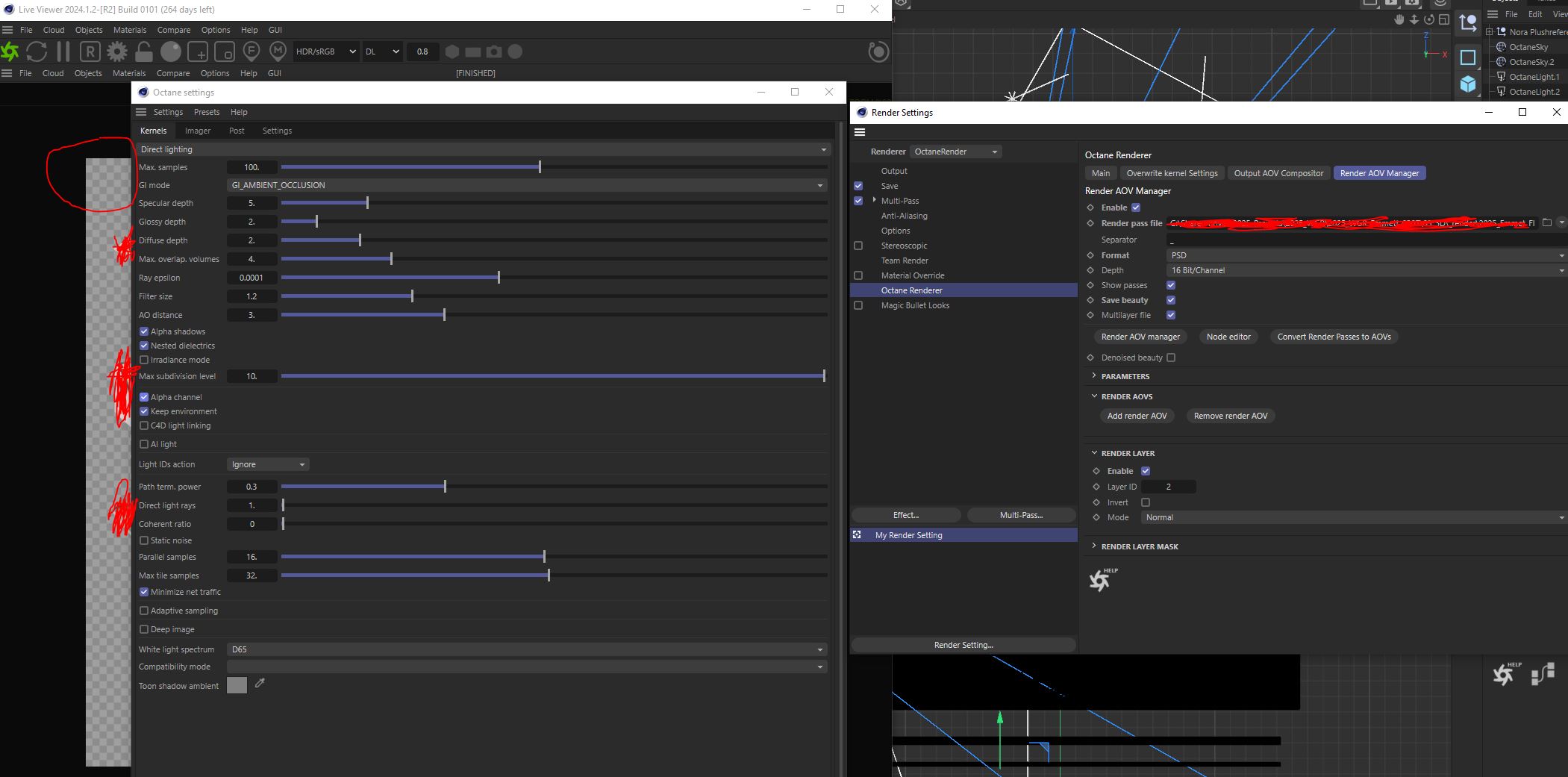

After updating to Octane 2024.1.2 I'm unable to render an alpha channel to PSD renders. I must be missing something extremely basic, but I get a black background in my PSD. The live viewer shots a checkard board pattern, and from what I can tell my settings are right. I even tried placing an octane tag and rendering the "render layer" and still don't get an alpha channel out. Help?

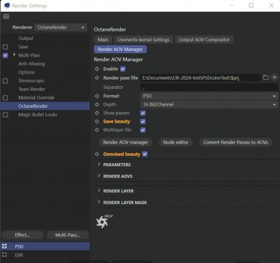

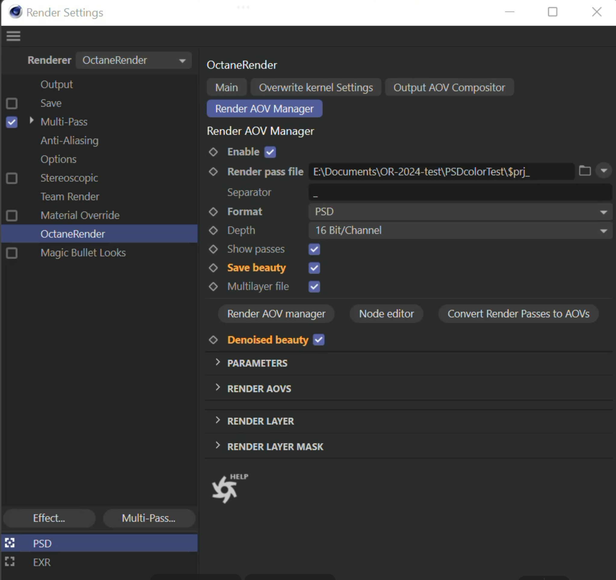

The workaround is to enable Denoiser in the scene, then also enable both "Save beauty" and "Denoised beauty" checkboxes in Render AOV Manager tab:
In this way, Denoised beauty AOV will correctly have the alpha channel.
