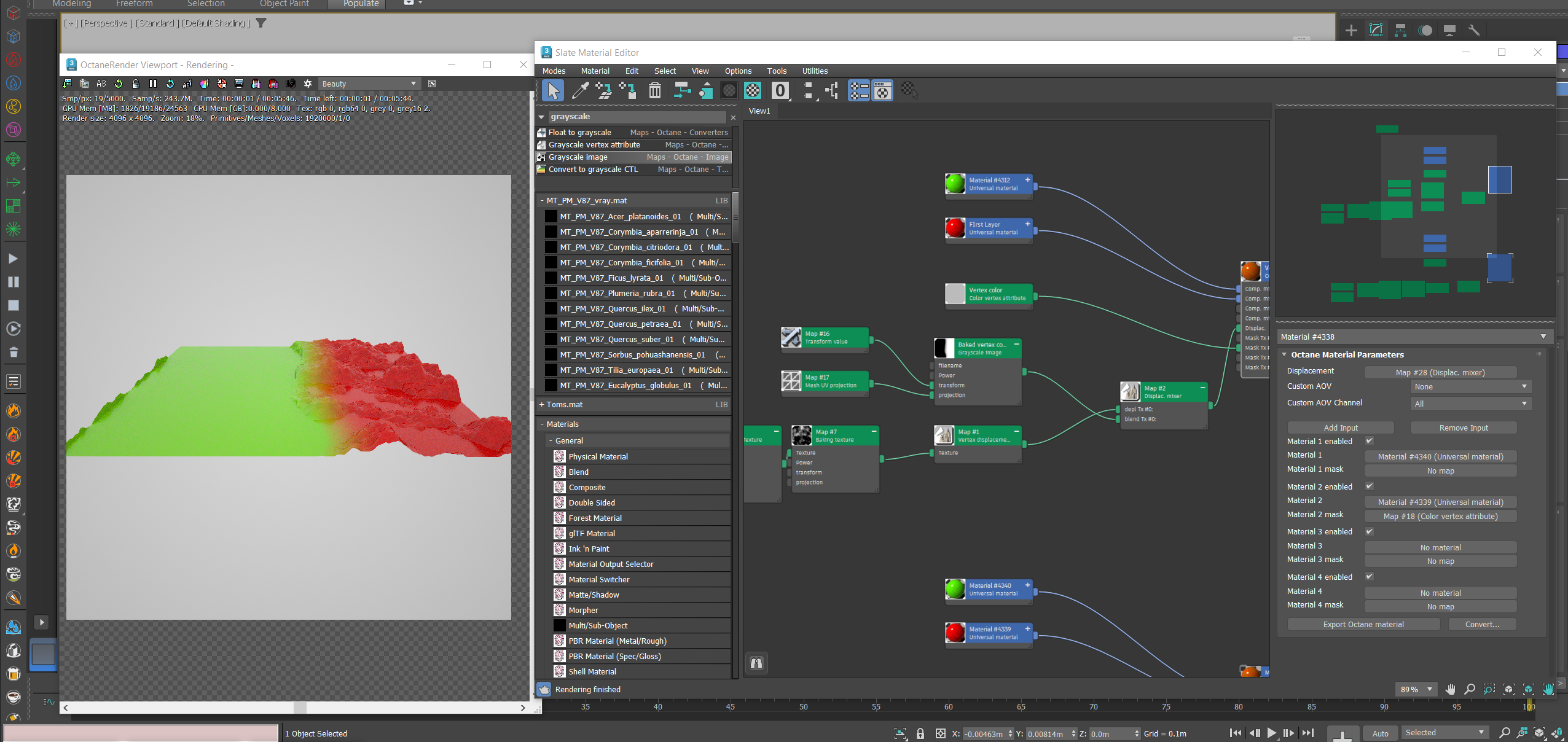

Hi tombyrom,
Thanks, I see what you're saying now. From what I remember, this is a known issue (related to the SDK). I tried using a single material with the mixer displacement node, but it didn’t seem to make a difference (attached screenshot). I’m reporting it to the developers to see if it’s a workflow issue and if there’s a quick fix.
Regards
Paride
