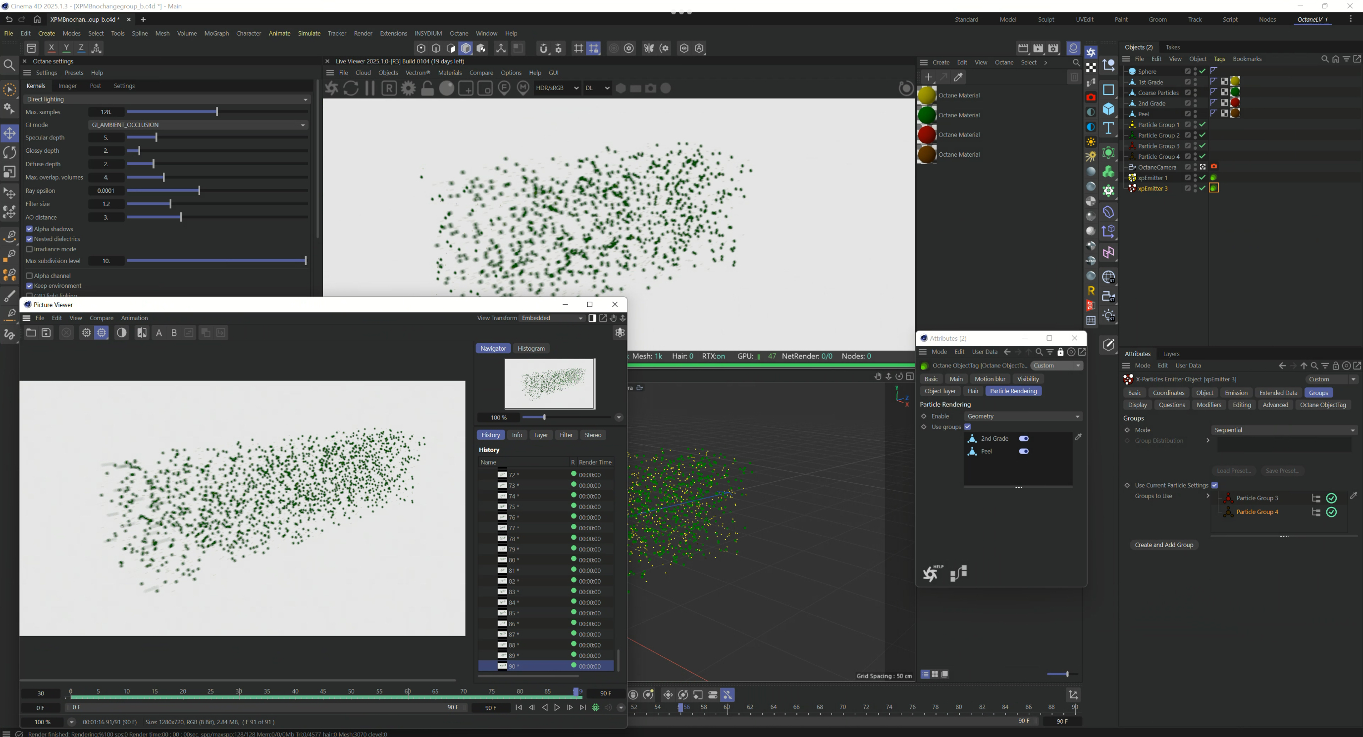

Posts: 10632
Ok, the issue is caused by xpChangeGroup objects, if you remove them and use groups in "normal" way, it doesn't crash with motion blur:
ciao,
Beppe

Posts: 10632
the "Use groups" support is quite limited, and your setup is something that plugin doesn't expect.
You have four emitters with one group each, but four objects assigned in Octane tag each.
Here is a setup that plugin is expecting:
XPMBnochangegroup_b.zip
(274.21 KiB) Downloaded 83 times
Only two Emitters, with two groups each, and two objects per Octane tag:
ciao,
