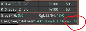

There is also small unfixed UI bug with displaying the amount of free vram:
