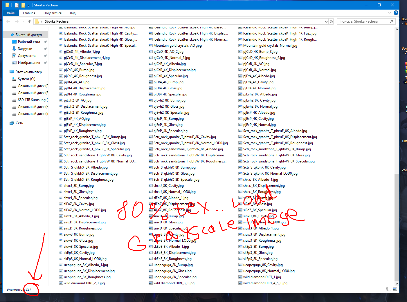

We need a function for assembling textures into one folder, the native function does not understand Grayscale imege and the texture is considered lost, a third-party plugin does not see it either, I have large scenes created through Grayscale imege and I cannot transfer the archive to another artist in 3ds max format, this function should also search for paths to the folder with textures

An example of a situation, I archived it through my manager, transferred the file to another person, by default my paths to textures remained in the archive, another artist needs to indicate the path to his computer, but everything connected through this node becomes lost from the search, that’s why the built-in search and archiving function is needed, which is fully compatible with the octane render functionality. I guess I’m the first to use this node for its intended purpose, since no one has written a post before. Grayscale imege allows you to automatically make color textures black and white, but they also compress them in video memory, they compress even initially black and white textures into much less weight.
