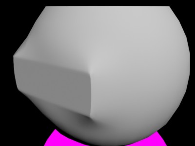

Here is scanline and octane lowpoly+normal map

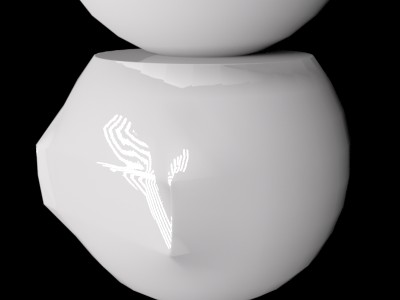

tombyrom wrote:Did you bake the normal using the octane camera in bake mode? I could never get a good normal map bake from octane in 3dsmax...
I looked at your file, not sure what the issue is, the material in octane is glossy and the one in scanline is not?
The issue is octane doesn`t render normal map correctly not as a glossy material and also diffuse material renders incorrectly with normals as well. At the same time scanline renders this normal map perfectly. You can see that at the images I have attached above

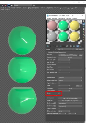

Hi be_fast,
I'm not sure I fully understand the issue. Have you tried checking the invert box on the normal map?
Regards
Paride

paride4331 wrote:Hi be_fast,
Regards
Paride
Yes I did. It looks fine on your render.
I have artifacts somehow
https://i.gyazo.com/a3365761f1009d814ab ... d2274d.png
