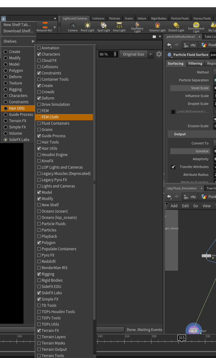

Noob question again : I've deleted the octane shelf by mistake, how can I restore it ?

Hi, there is a + sign on the shelf, click it then go to Shelves/Octane

The issue is that it doesn't appear anymore in the shelf :(
