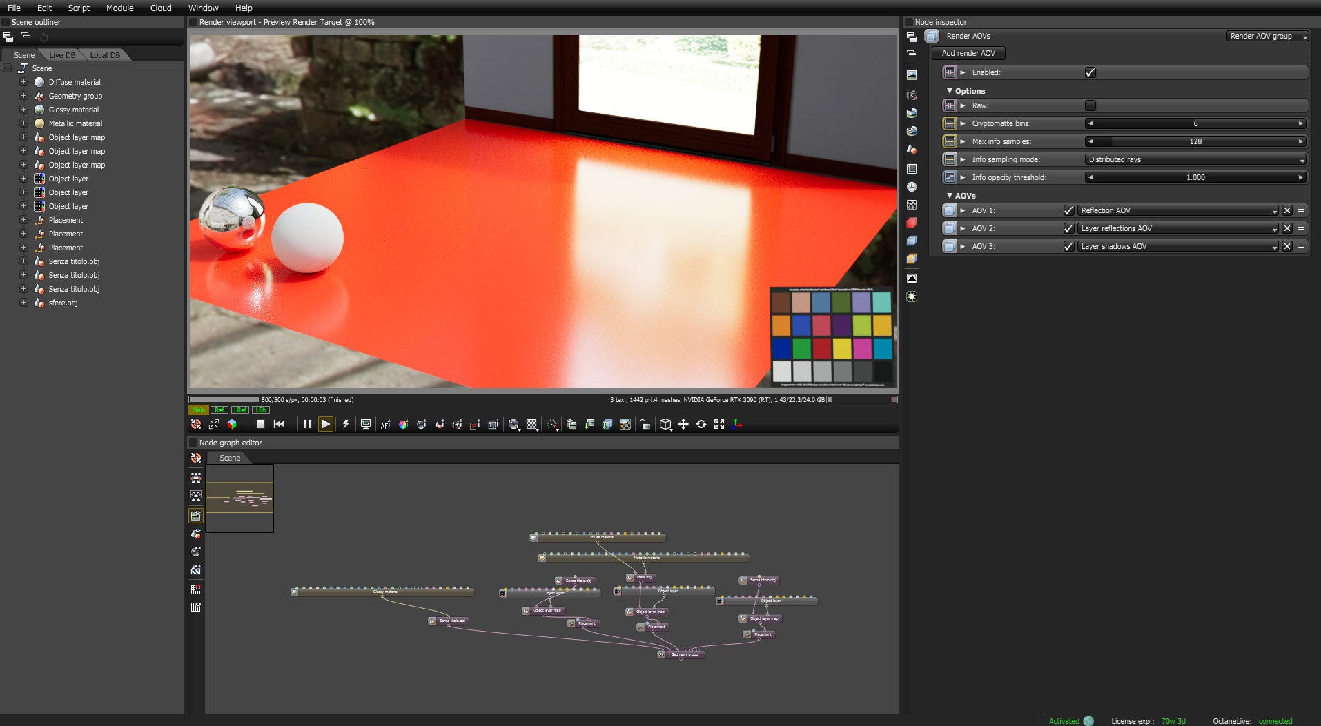

I am not clear on how the Layer reflection AOV works.
If I activate both the Layer shadows AOV and the Layer reflection AOV in a material for example with red diffusion (not metallic) and a certain reflection, I get correct gray shadows, but a red reflection.
The reflection, in a non-metallic material, even if red, should be gray or am I doing something wrong?

Sorry, I'll try to be clearer.
First of all I attach the test scene
Reflection test.ocs
(68.24 KiB) Downloaded 680 times
The scene is composed of two render layers and three Render AOVs (Reflection, Layer reflection and Layer shadow).
From the scene, by disabling the Render Layer, it is possible to see in the Reflection AOV how the reflections are colorless despite the reflective material (not reflected) being red.
By reactivating the Render layer, the Layer reflection AOV instead contains, in addition to the reflections, also a contamination of the red of the material.

Posts: 10585

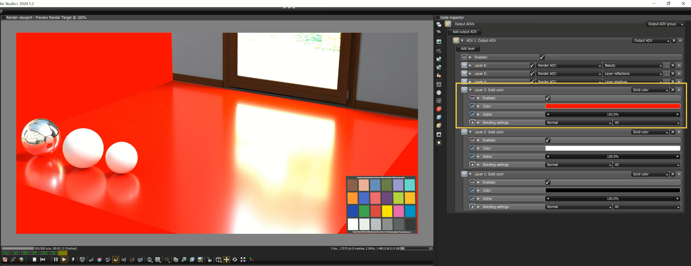

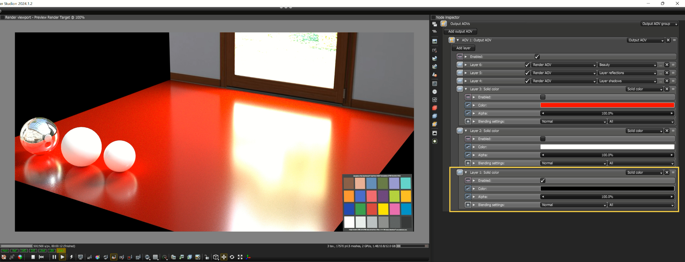

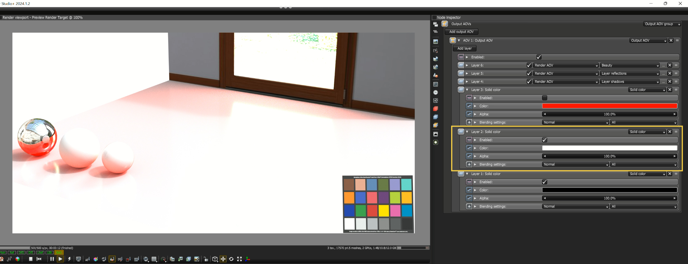

Thanks for sharing the .orbx file.
Ok, it also considers the diffuse indirect contribution for compositing, so it must be judged in compositing.
If composed on Black background color, you can have back the original scene:
While here is on White or Red background:
Here is the scene:
Layer reflection_b.7z
(15.38 MiB) Downloaded 701 times
