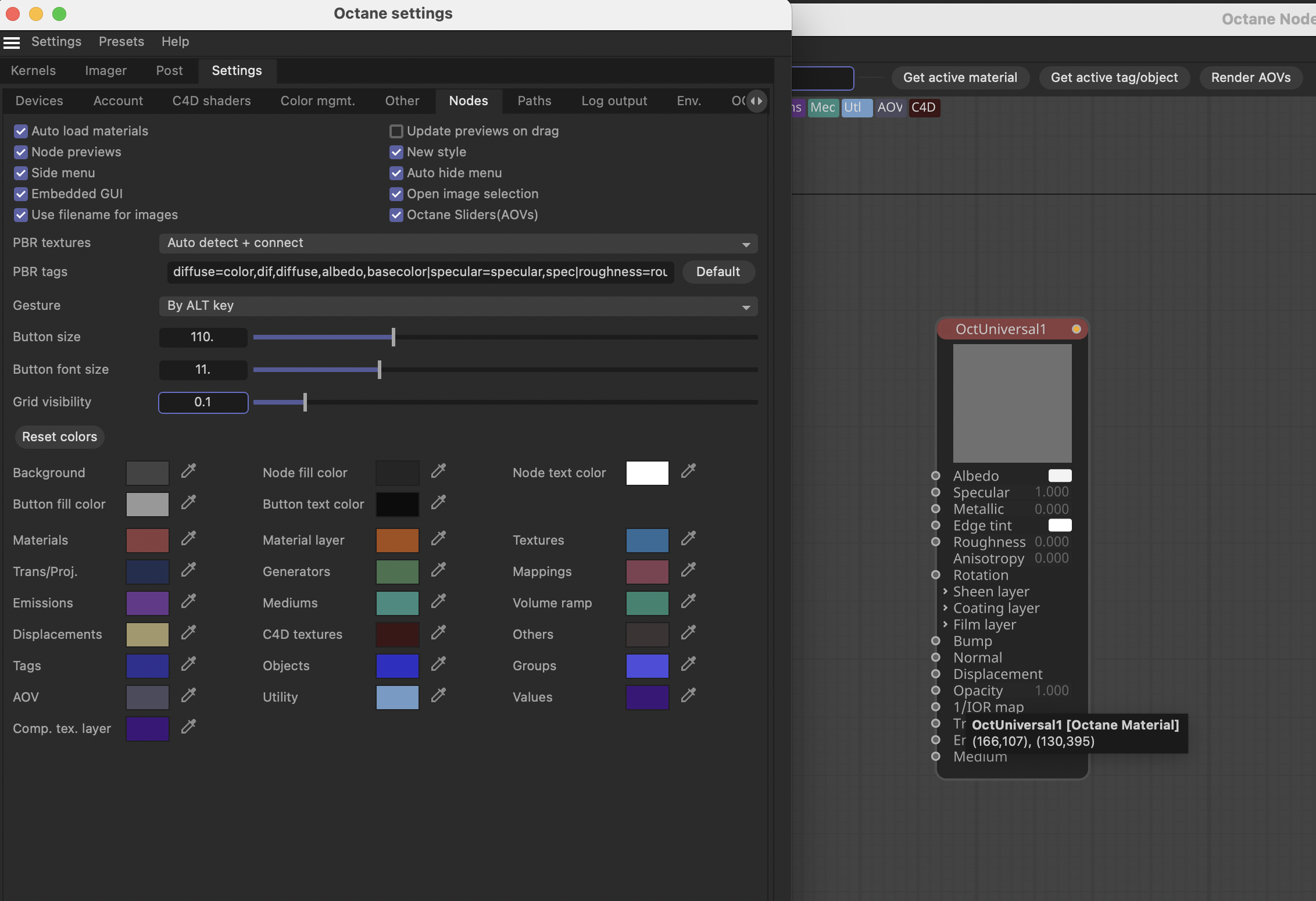

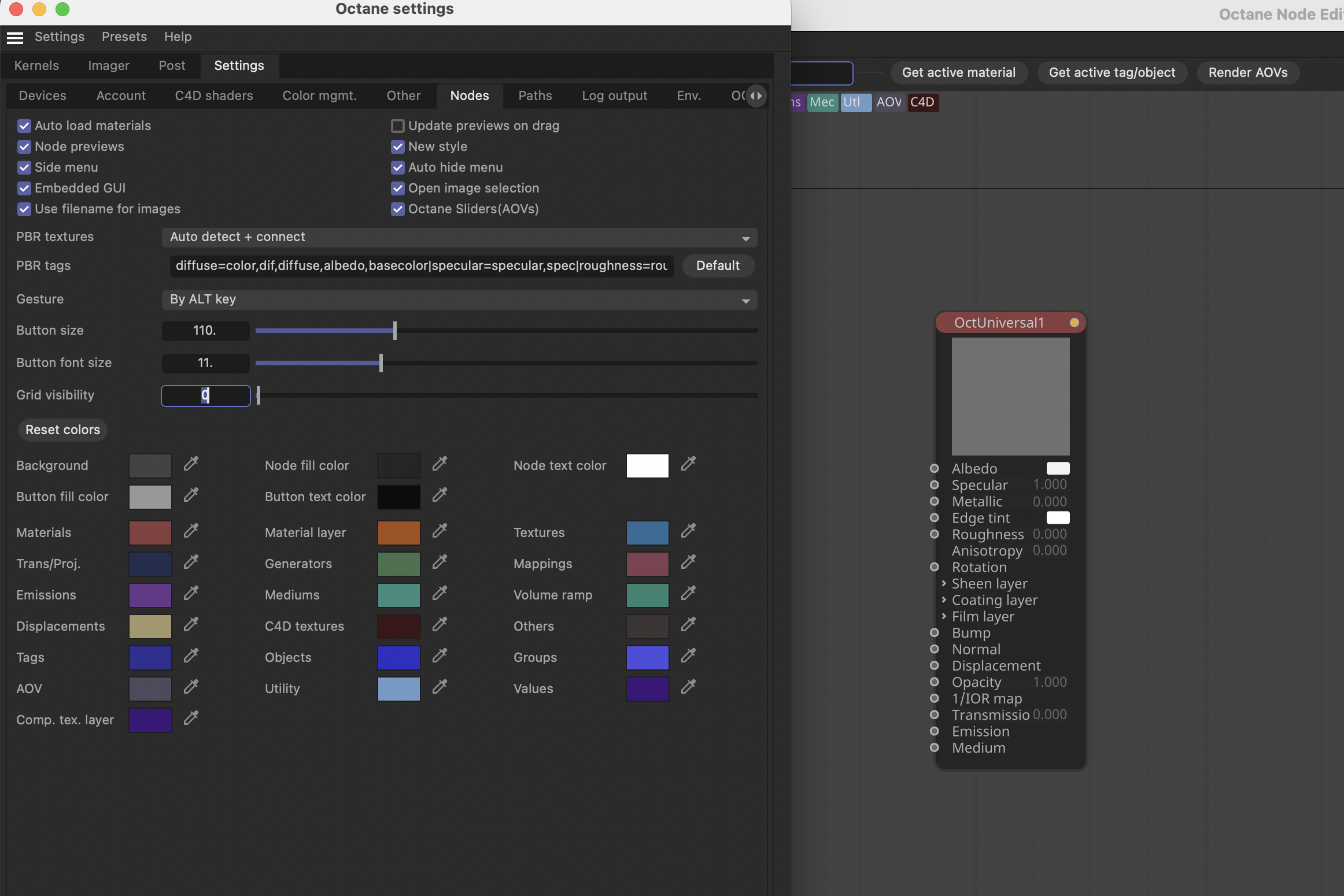

Pretty straightforward - when you set the grid visibility to 0 for the node editor, the grid is still there regardless of the screen scaling or zoom level.
Mac OS Sequoia 15.2, Octane 20204.1.2, Cinema 4D 2025.1.1
Grid vis. in the node editor doesn't go to 0 on the Mac

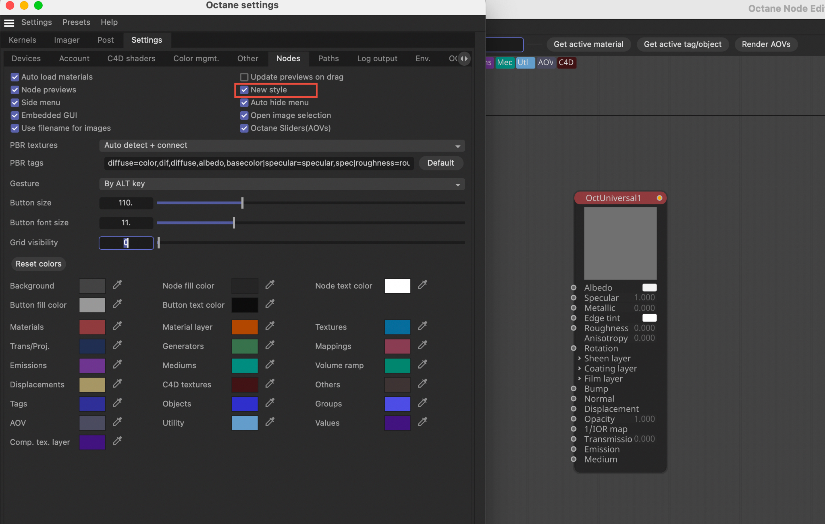

under macOS, you need to disable the "new style" option: ciao,
Beppe
Beppe
