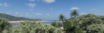

Hey,
this only happens on heavy scenes, not texture heavy but geometry heavy.
Like the attached
I will try an update my 3ds max see if it helps.
