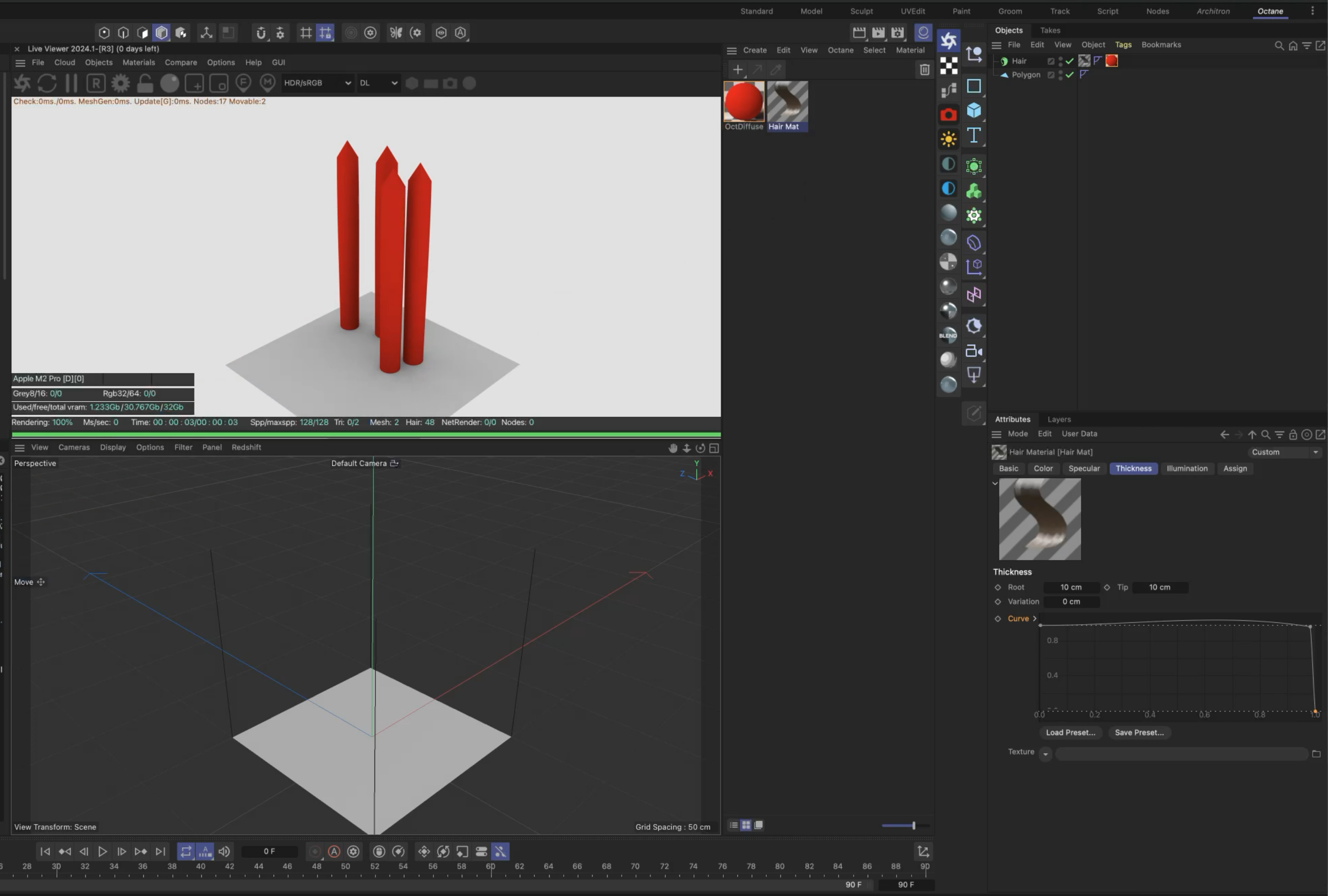

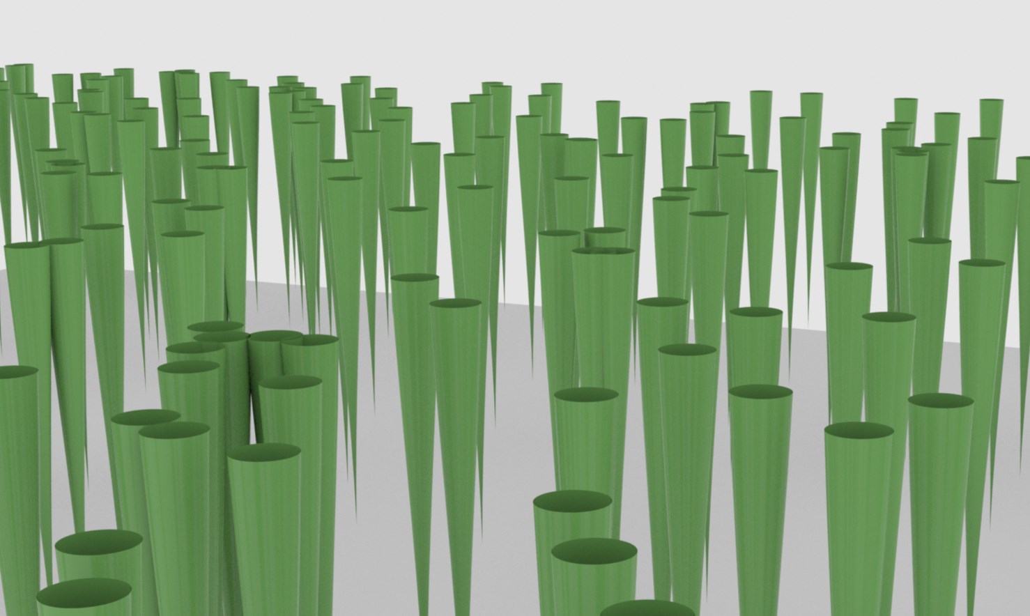

Is there a way in octane to have hair but with caps ?
Posts: 10611
nope, but you can edit the Curve in the Thickness channel of the Hair Material to have something like this:
