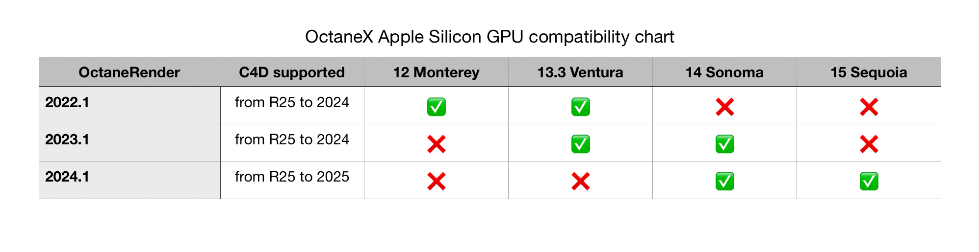

the issue is in macOS version, you need macOS 14 Sonoma or 15 Sequoia for OctaneRender 2024.1 or greater.
ciao,
Beppe
