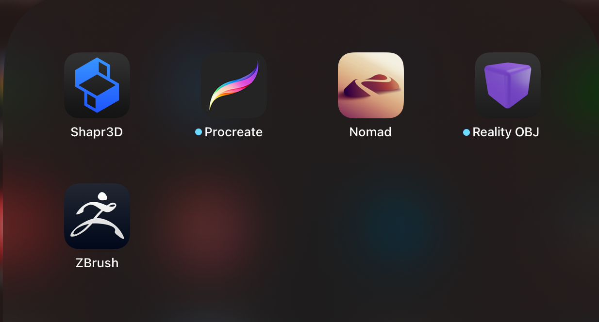

Here are the other apps I'm using more:

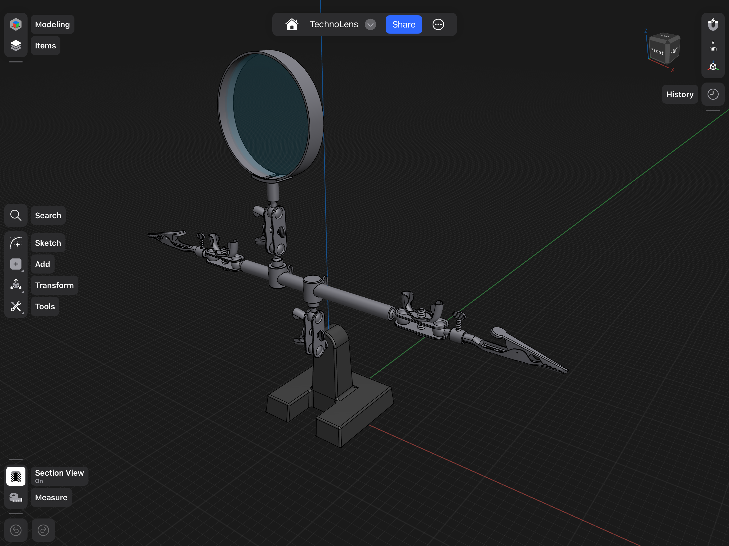

My preferred one is Shaper 3D for modeling:
And import the models in OctaneX via OBJ, or USDZ format:
I'm not a sculptor, but Nomad Sculpt and Zbrush are working very very well on iPad, while I'm using Procreate for texturing and painting the models.
Finally, I'm using Reality OBJ for converting Nomad Sculpt OBJs to USDZ to keep the vertex paint.
