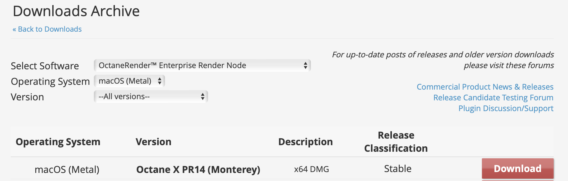

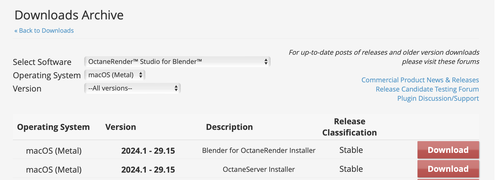

What version do I have to install to get this working with blender.
The main working machine is M1 Pro with Blender
Render Nodes are mostly Windows machines and some M1 Pro Macs
Those are the Download options
Any help appreciated

As long as the node is 2024.1, it should work with 29.15.

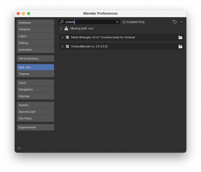

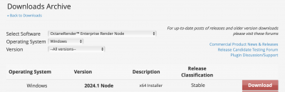

It does. Please check your installed versions. 2024.1 windows render node with blender 29.13 addon version

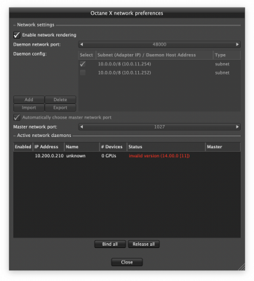

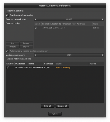

I also digged a bit deeper in why it is not working with 2 different network adapters like WIFI and ETHERNET.
In my case the Wifi is bound to .254 and Ethernet is .252.
In order to work over ethernet I have to change it to 252 but have not found a way to do that.
Any hints appreciated.

I have also tested the 29.15 Blender Octane version and the render node does not work here. I get the same error message that David got.
