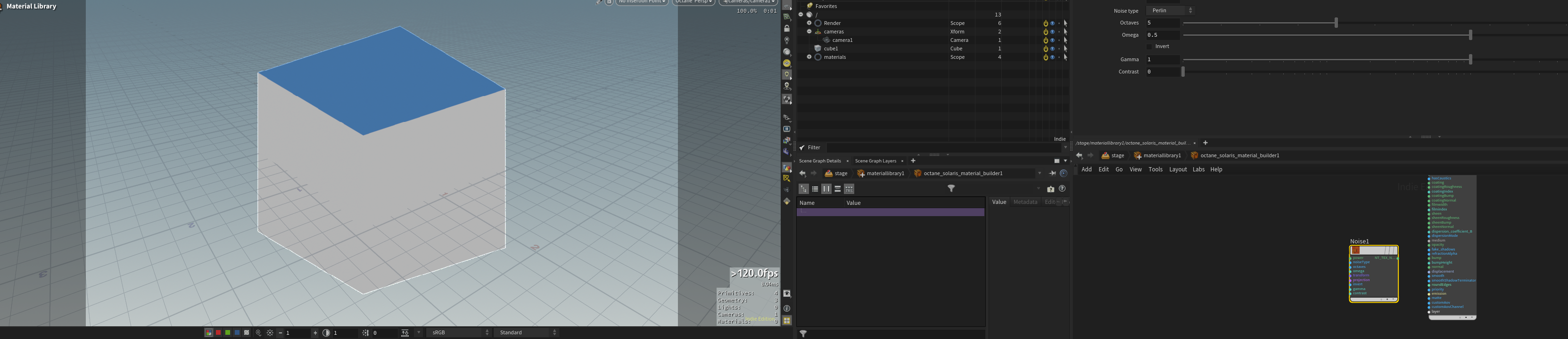

Setting a camera to orthographic projection seems to turn materials pure black if using the bump input.

madssigurd wrote:Setting a camera to orthographic projection seems to turn materials pure black if using the bump input.
Hi madssigurd, Thanks for the post.. we ran a test and it seems to work fine.. Could you please share the above file for us to test?
Cheers
