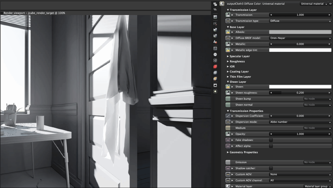

More or less the same approach applied on these renders from an upcoming post on Fabric shading.
Not a curtain but a similar. This one uses Diffuse transmission mode, no opacity, no medium (sheen was disabled):

Transmission type set to Specular essentially results in a "glass like" material. Not the most suited for such rough fabric.
In this configuration, the Diffuse "color" parameter is basically an "opaque parameter".
it may also introduce "fireflies" depending on the render kernel. Here, DL Kernel could suffice and PT suited but requires fine tuning.
