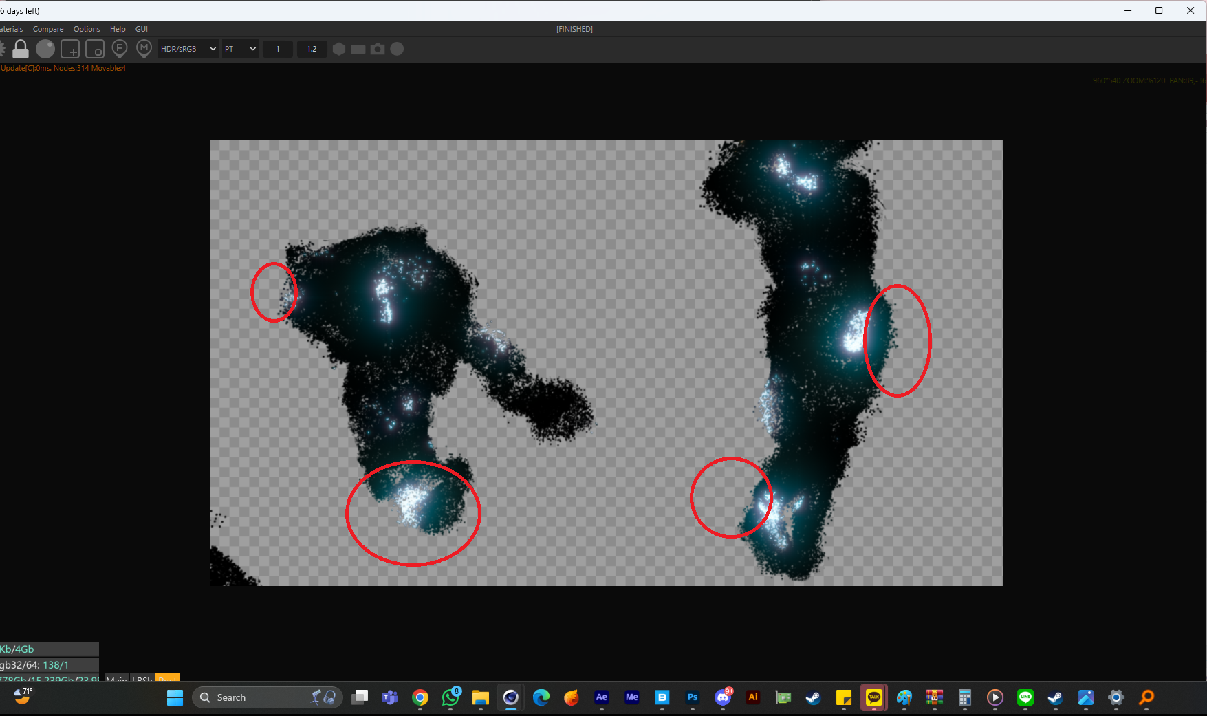

When I render a specific layer ID, and with AOVs with alpha turned on in octane settings, the post processing seems to get cut off.
The halation/bloom is being cut off when I turn on alpha channel.
This is on the latest Octane 2024.1-[R2], and same problem happens with 4-5 versions below this
I rolled back to 2023.1-R7 and its working! Is it possible for it to be fixed in the next Octane version??? I want to use it for my current work but its unfortunate to use an older Octane
for this issue that doesn't get fixed.

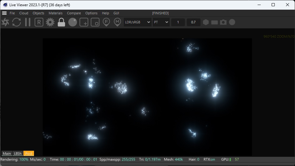

It should be like the 1st picture where it is all black on the post processing AOV.
