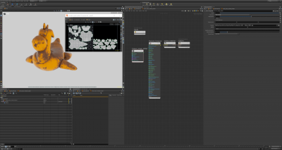

sidseed wrote:Hello,
The UDIM texture node is not working in Solaris.
Everything is working just fine in OBJ level, but no luck in LOPs.
Thank you,
Works for me. ( 2023.1.3.4 build )

Oh yes... You are correct. Was using <udim> instead of proper <UDIM>.
