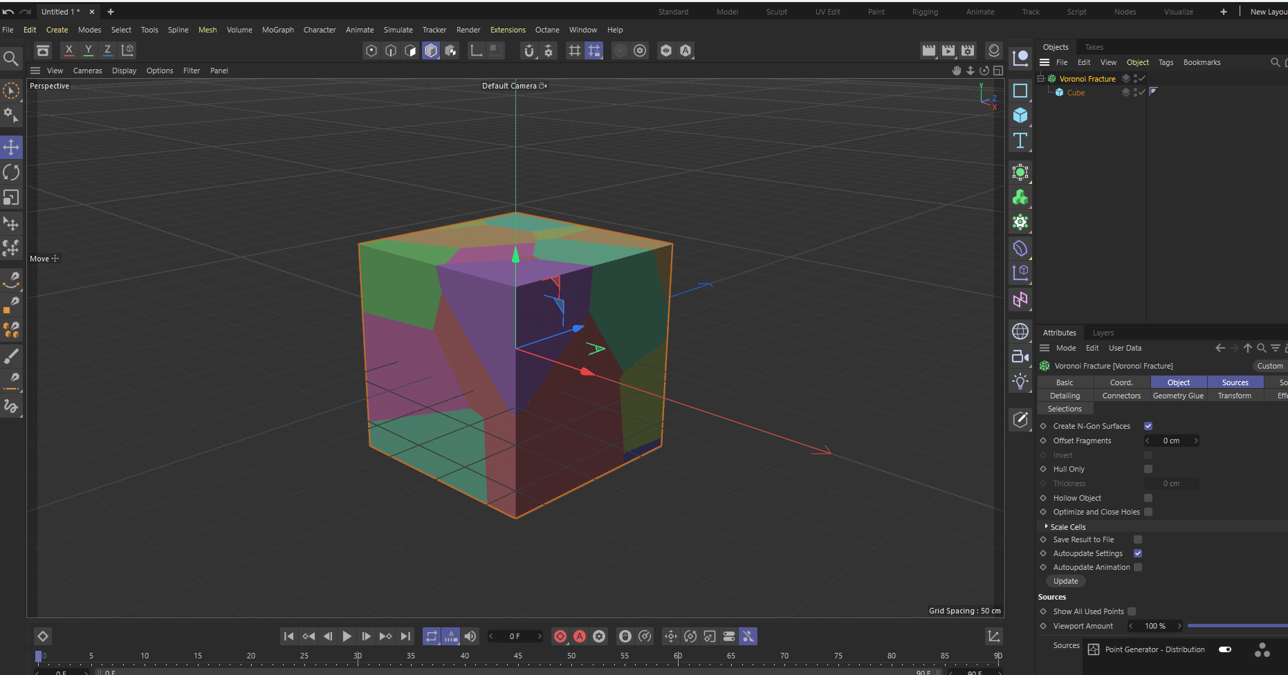

Hello, I recently came across a problem when trying to open live viewer in a very simple scene. As soon as i place a "VORONOI FRACTURE" into the scene and place my cuber under it, I click live viewer to open it and it octane crashes immediately. I've provided screenshots for what the scene looks like, and the bug report(s). I've tested this in C4D R25 and C4D 2023 (Using OctaneRender for Cinema 4D 2023.1.3-[R4] & Nvidia Studio Driver 560.81), same result. I've worked with voronoi fractures in octane before but never experienced this problem. I have listed the specs of my brand new build I just purcahsed a week ago, and ive rendered plenty of scenes ranging from simple to complex without troubles, so very curious as to what is happening.
However, I did try the same scene setup on C4D R21, with OctaneRender for Cinema 4D 2021.1.1-(R3) and it worked fine. (I can provide laptop specs and nvidia driver version if needed)
Any help would be much appreciated! Thanks.
Screengrab from C4D
Screengrab from C4D
