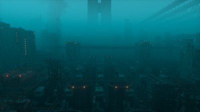

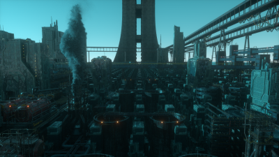

I'm having an issue with using an Open VDB and also a Octane fog volume. With both in the scene as you will see attached, the fog volume cancels out the smoke plume VDB. I know this is how the system is supposed to work but is there a work around so that I can see both my fog volume and the open VDB smoke plume in the same scene? I mainly don't want the smoke VDB to be completely opaque. Any help would be much appreciated.
