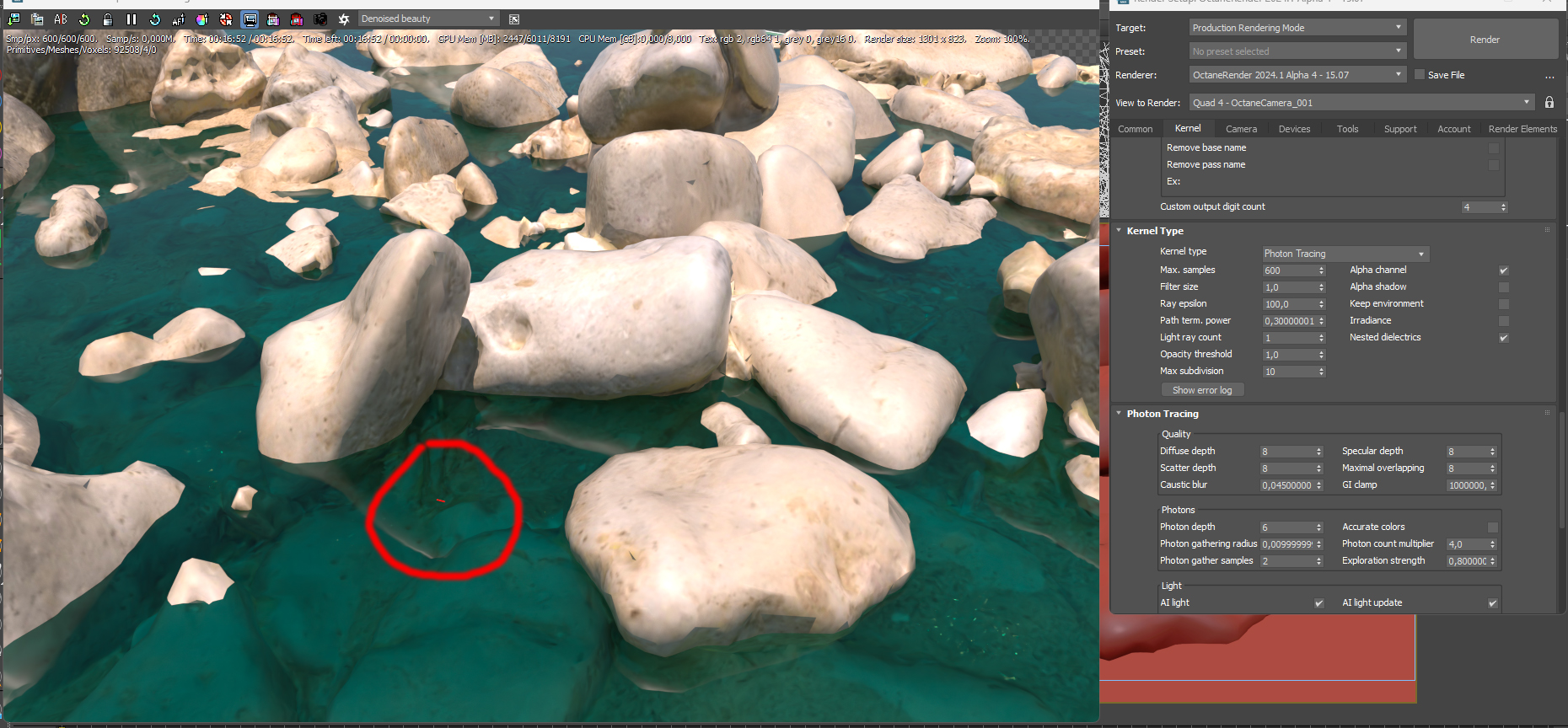

I tried as you suggested with a scene extending 50km x 50km and an overhead shot from 5km. The red cuboid visible in the scene is 50 meters long.
The sea, of course, uses a specular with a displacement map. After setting the ray epsilon, there don't seem to be any artifacts. Am I doing something wrong?
Regards
Paride

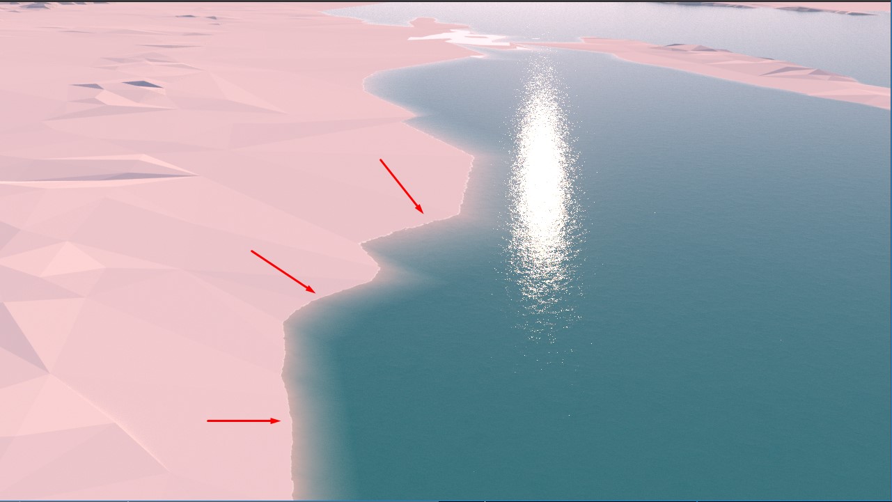

Hi Paride,
i noticed you're using Photon Kernel, i'm using Path Tracing instead - but i do not think this is the issue.
Anyway, in order to let you try better, i attach the ORBX i just exported.
There is no texture, displacement is just an Octane baked noise.
In the picture below you can see the border between terrain and water.
Let me know if ORBX loads fine and if you get the issue.
Best
Paolo
Best
Paolo

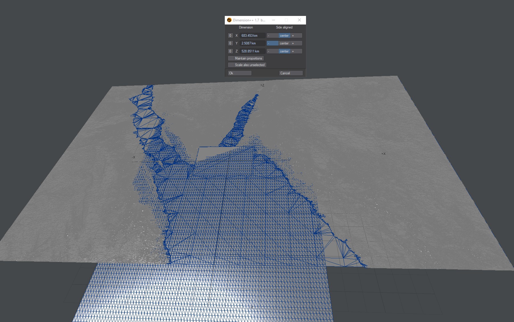

here is the FBX - effectively it's much bigger. In the screenshot you see real world measurements.
The bug will appear even on much, much smaller scenes but this way you'll be sure that you get it
Just assign a diffuse material to terrain and a Texture displacement to water.
Let me know if it works,
best
Paolo
best
Paolo

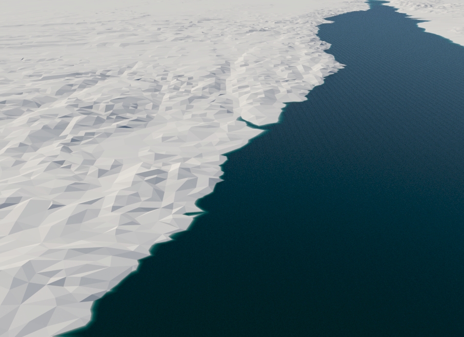

I did some tests, honestly I think your issue is caused by measurement unit errors and material settings. Additionally, the issue with black lines at intersections, which sometimes occurs when using texture displacement, is usually resolved by adjusting the ray epsilon setting. The texture displacement node certainly has some limitations and issues and will be replaced with a new texture displacement node in the near future. Using the baking texture in this particular situation is, in my opinion, highly inadvisable. Instead, use a normal seamless texture (which I didn't use in my test); everything seems to work fine. I would also consider using the vertex displacement node in conjunction with the relative distance node (I’ve attached a test .orbx). I’d recommend taking a look at that as well.
Regards
Paride
https://we.tl/t-Z9S0poSduT
https://www.youtube.com/watch?v=ucgYAWj88hs
Regards
Paride
