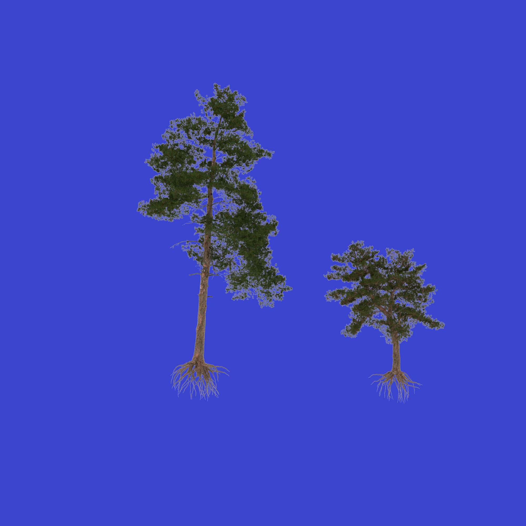

Hi im doing a project and they send me a pine model.
Some of the pine needles render as this blurry alpha border.
is there a way to fix it in octane settings?
chocking the matte out will eat out small branches and detail too
attached a picture of the problem

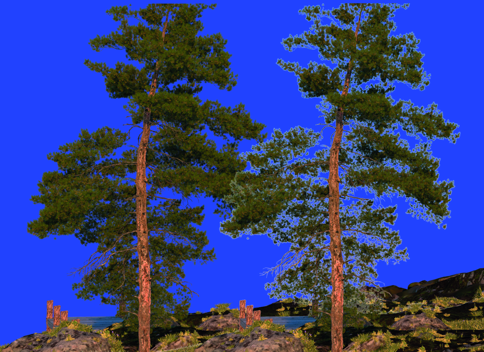

Hey Thanks million.
It was the keep enviroment. why does it do that to alpha if its left on?
I'll attatch a picture if some one is searching for this problem. Tree on the left is keep enviroment off and right one is on.
