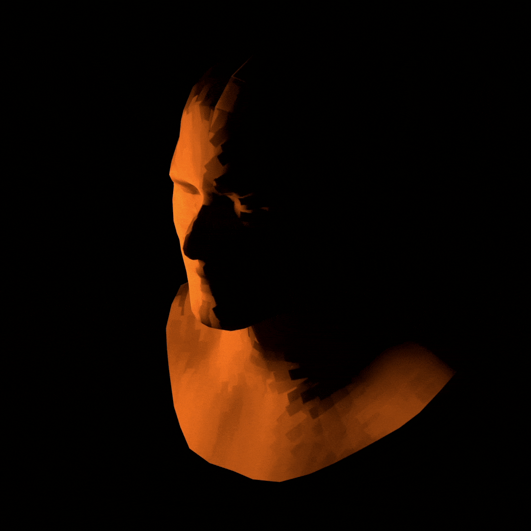

Demonstration 1 (Omni Light in the Standard Renderer)
For example, in the GIF below, this is how Cinema 4D's Omni Light interacts with a Normal map that was baked in Object space:
(please open the image below to play the GIF)
Take note of how Cinema 4D's Omni Light "reveals" the rectangles on the Normal map.

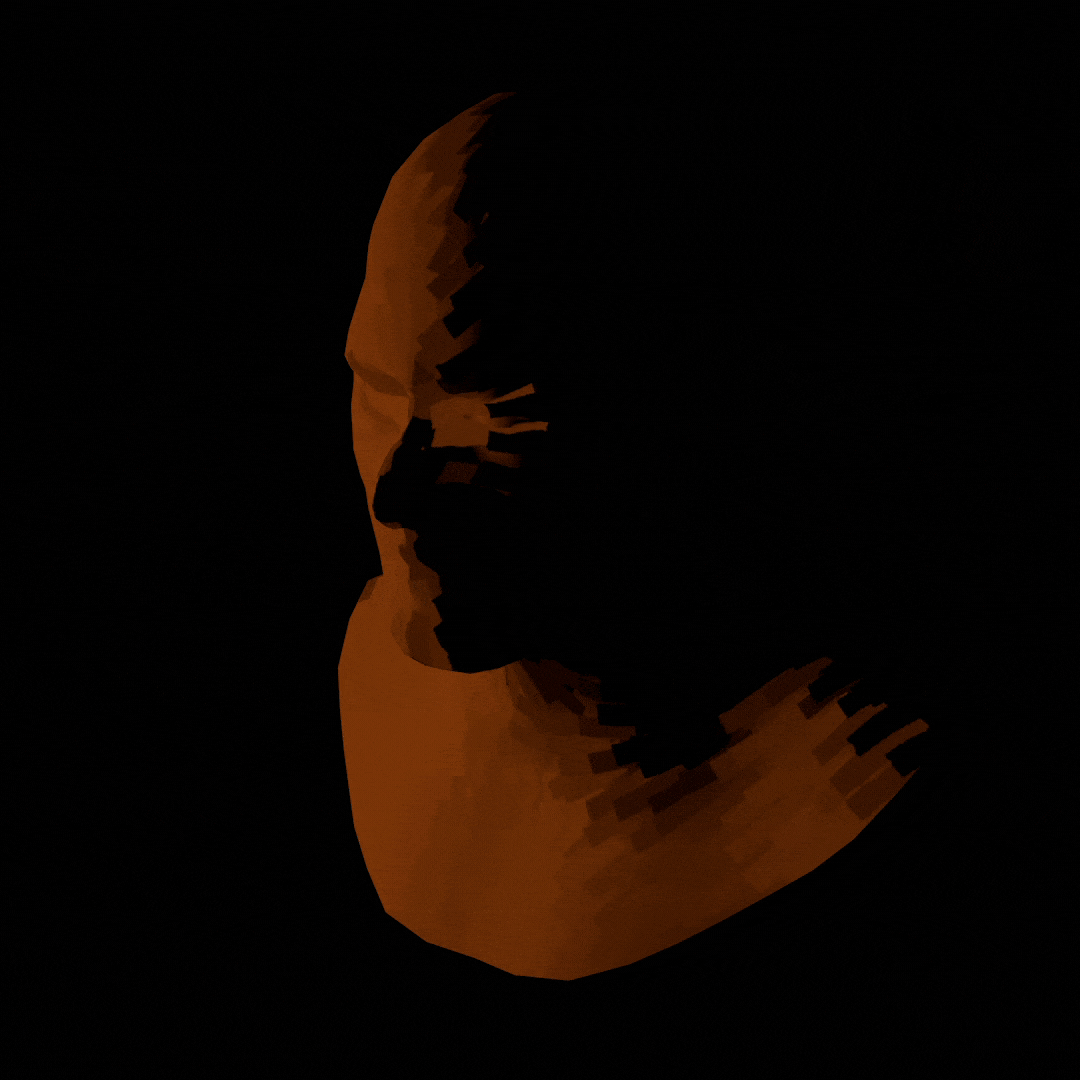

Demonstration 2 (Area Light in Octane Renderer)
In comparison, this is how Octane's Area Light interacts with the same Normal map that was baked in Object space:
Take note of how Octane's Area Light fails to replicate the way Cinema 4D's Omni Light "reveals" the rectangles on the Normal map.

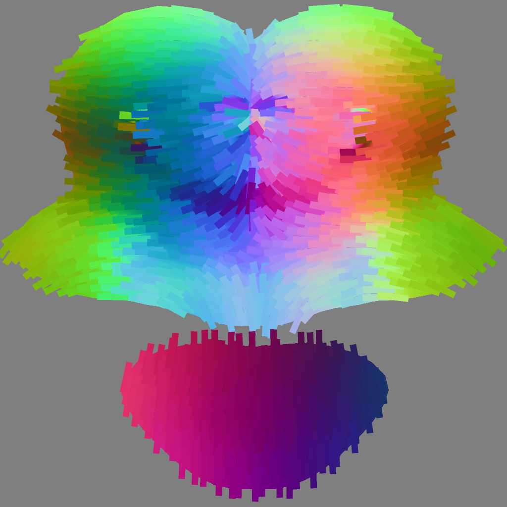

This is the Normal map in question:
The Normal map baked in Object space.
Observations
As you can observe in the GIFs above, the "rectangle" shapes on the Normal map are revealed by the scene's Light in very different ways. I understand that the root cause is most likely that the Omni Light is biased, while the Area Light is unbiased.
Given this, I ask you: with the help of any technique or form of trickery, in Octane, is there any way I could possibly replicate the way Cinema 4D's Omni Light interacts with my Normal map as seen in the first GIF above?
