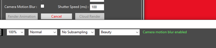

When I export and animation. The plug-in starts saying setting up camera motion blur. I do not have this feature enabled in the settings shown and screenshot. But the viewport window also says camera motion blur enabled. Why is that when I don't have the box checked.
And it seems that the motion blur takes up some time to set up before exporting. So if I have a big file to export it takes up a substantial amount of time before the setup is complete. Before its start exporting.
Is this a Bug?
Camera motion blur enabled

Hi
When exporting to ORBX, camera motion blur is always enabled, since I guess is it assumed that in general users want camera motion blur.
Paul
