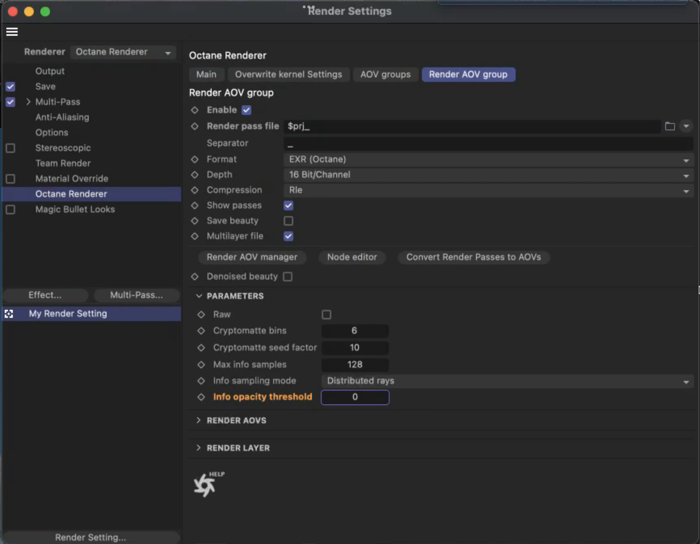

i need a Cryptomate or Material ID Pass from a Object that is not visible? Any Ideas for this? In Corona-Renderer i can easily set Index to 1 and then Object visually
disapears but is visible in Renderpasses. Is something similar possible...

Hi Christian,
in Render Settings/OctaneRender/Render AOV group tab, Parameters section, there is an Info Opacity Threshold parameter, but it works for Info AOVs only, not Cryptomatte:
