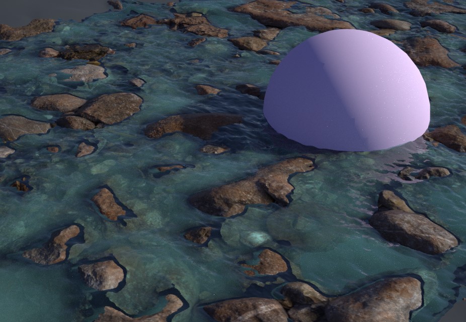

I have this issue when I use a displacement on a transparent material, like water. See attached.
It creates these black outlines around the mesh that i comes in contact with. The displace is at 8k tiling and that reduces it, but it does not go away.
Has anyone encountered this or know a fix?

I get same issue all over the time, for many years.
It depends on two factors:
- the actual projection size of the texture you're using for displacement. Same texture projected as a 20mx20m or as 100m x 100m will produce different black offset borders. The larger the projection, the larger the black line.
- The pixel resolution of your texture. The higher the resolution, the smaller the black border.
Afaik there is no solution atm. You'll always end with a black line somehow. This is tremendously bad for water and sea in general.

thanks for your input. I have to agree with Pavlov on this. I do alot of water sims and renderings, and I find myself moving away from displacement mapping and using bump maps, which is of lesser quality in the end product.
I really hope that this can be fixed
I have attached a scene and a fast render for you guys. In the render you can see the white rim around the stones, this is the problem.

Personally, I wouldn't choose this workflow to achieve this image, but that's not the subject of the post. That being said, as you can see, Octane Render's displacement nodes work well when used properly. I'm attaching the file so you can take a look and compare it with yours, in order to learn some useful tricks as well as the Kernel settings (Perhaps the use of the ray epsilon function was overlooked). I also add that it is not feasible to achieve a decent displacement using a low-resolution 8-bit JPG image. Additionally, when using a grayscale image (at least 16-bit depth and of adequate resolution), it would be correct to use the grayscale node instead of RGB. However, one thing should be mentioned: the interpenetration of the 'water' plane and the stones should be avoided. I didn't perform any boolean operations, precisely to demonstrate that the displacement works well anyway. I hope it's helpful.

Thanks man, appreciate your time on this.
The scene that i made for you is just to highlight the obvious, so thats not how i do the scene normally.
Here are some shots where I camouflaged the borders with white foam, but some places you can see a black trim on the stones in the water.

Did you use texture displacement or vertex displacement node?

For the video i used texture displacement.

try to take a look at my water material.
In any case if you have too many sharp edges, try increasing the texture detail of the geometry you're using, like water, or increasing the subdivision level of the vertex displacement.
