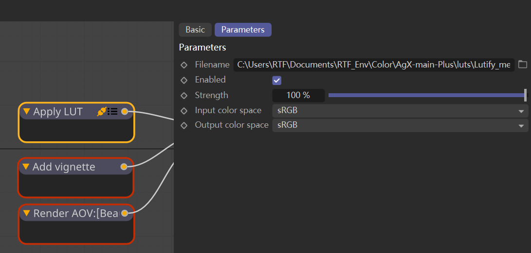

Could you please add a feature to the "apply LUT" node in Octane 2024 AOV?

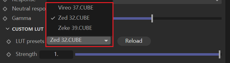

The custom LUT in the original camera tag had a list that made it easy to scroll through and change LUTs, which was very convenient for look development.
Could the "apply LUT" node achieve similar functionality? For instance, Octane could have a dedicated LUT folder where users can place their own LUTs, and then smoothly scroll through and switch LUTs within the "apply LUT" node.
Apply lut node Optimization suggestion

it is most likely of a high improbability that the input color space is intended to match the one of the output.
In such a "LUT context", the input is typically logarithmic (according to each manufacturer's own specifications) or "open-domain linear".
A complementary "transform / color processing" subsequent to AgX is inevitably breaking the imagery (image formation) making AgX reason-to-exist somewhat irrelevant as it turns into a counter-productive processing-chain.
