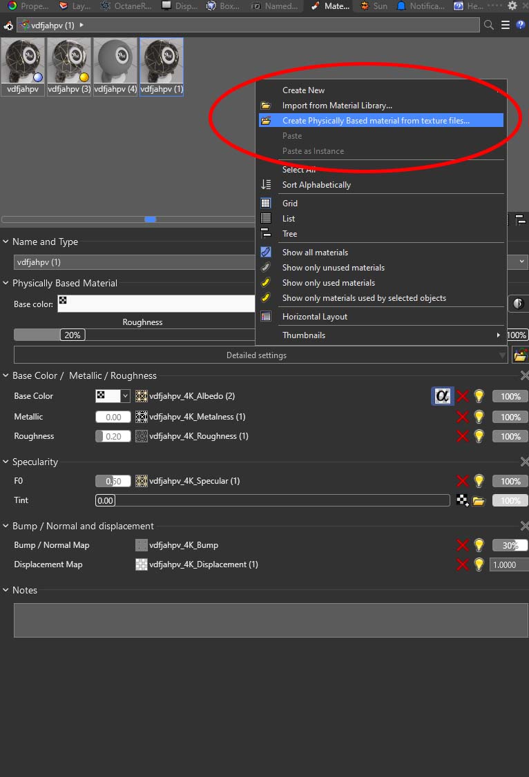

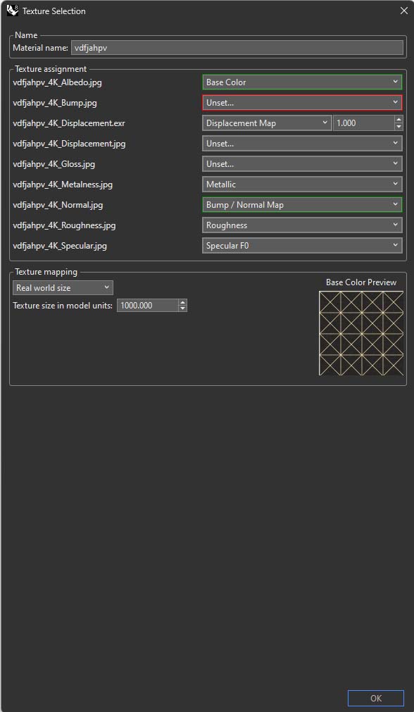

I am trying to find the best way to import downloaded Quixel Bridge textures into a Rhino octane material. I can import the files into Rhino's Physically based material slot easily using a zipped file of all the downloaded files, but when converting to Octane material it loses all the textures.
Is there another way rather than make an Octane material and manually point each section to the relevant texture?

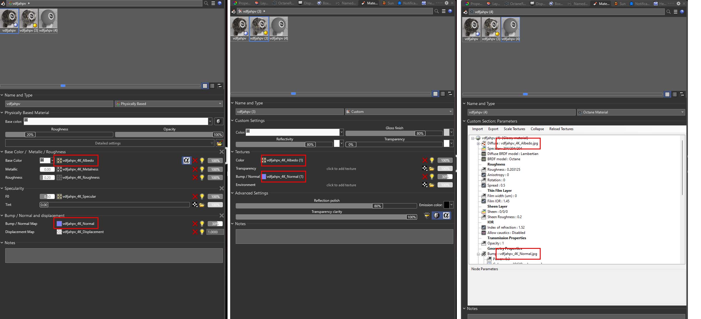

I've found that if I convert the Rhino Physically based material to a custom and then to an Octane material it keeps the base map and bump/normal at least. If you convert it straight from Physical to Octane none of the textures stay connected.
The reason for starting with a Physically based material is that I can create new material instantly from a zipped file of all the textures. Is it possible to have this option when creating a new Octane material?
