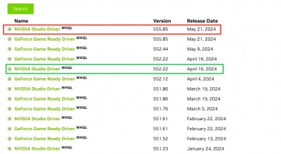

Stability issues with Studio Nvidia driver 555.85
Posts: 10661
Several users are reporting stability issues @OTOY Support about latest Studio Nvidia driver 555.85 version and c4doctane.
Performing a clean installation of previous Studio Nvidia driver 552.22 solves the problems.

I can confirm this 100%.
The late May Nvidia drivers totally destroyed my ability to render nearly anything.
And the more recent Nvidia drivers released around June 3/4 did nothing but make things worse.
Thanks so much for the information on how to get rendering again!

Unfortunately, with the 552.22 octane crashed immediately.
EDIT: reinstalled CUDNN manual. Now it works again.

Posts: 10661
Unfortunately, Nvidia Studio 560.70 version doesn't solve the stability issue, please stay with 552.22!
