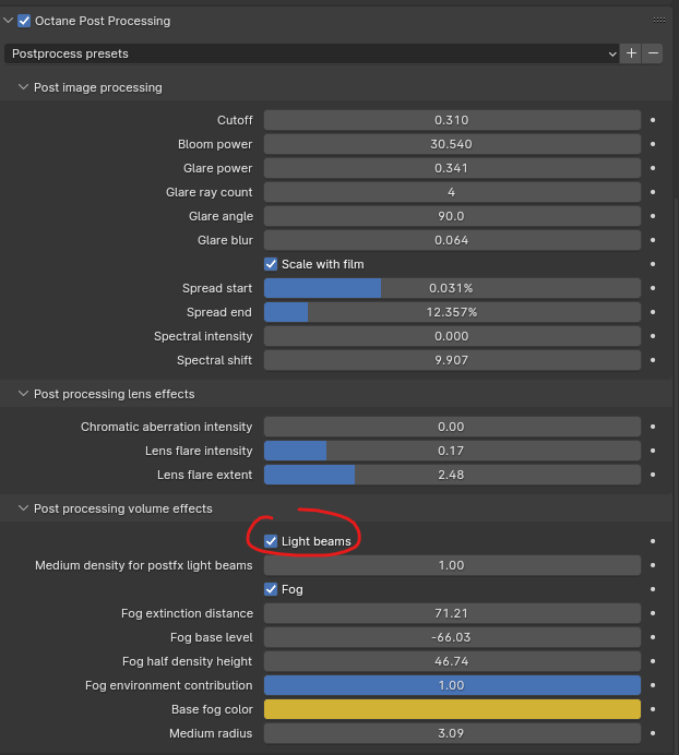

edit:
Hi Lino
I'm really sorry but I'm not sure how to get the light beams to work. I've tried all the settings and played around with the parameters but nothing happens. I could have sworn I got them working by accident a couple of weeks ago, but now I can't get it to work again.
In the sscreenshot you can see I have activated all post FX and yet beautyfull the Lightbeam Fx doesn´t appear.
Do I have a false setup or do I something I missing?
Thank you so much for your help!

edit:
Hi Lino

thx so much, Lino.
Works like a charme. What I missed was the last medium value to adjust correctly.
THX!!!
