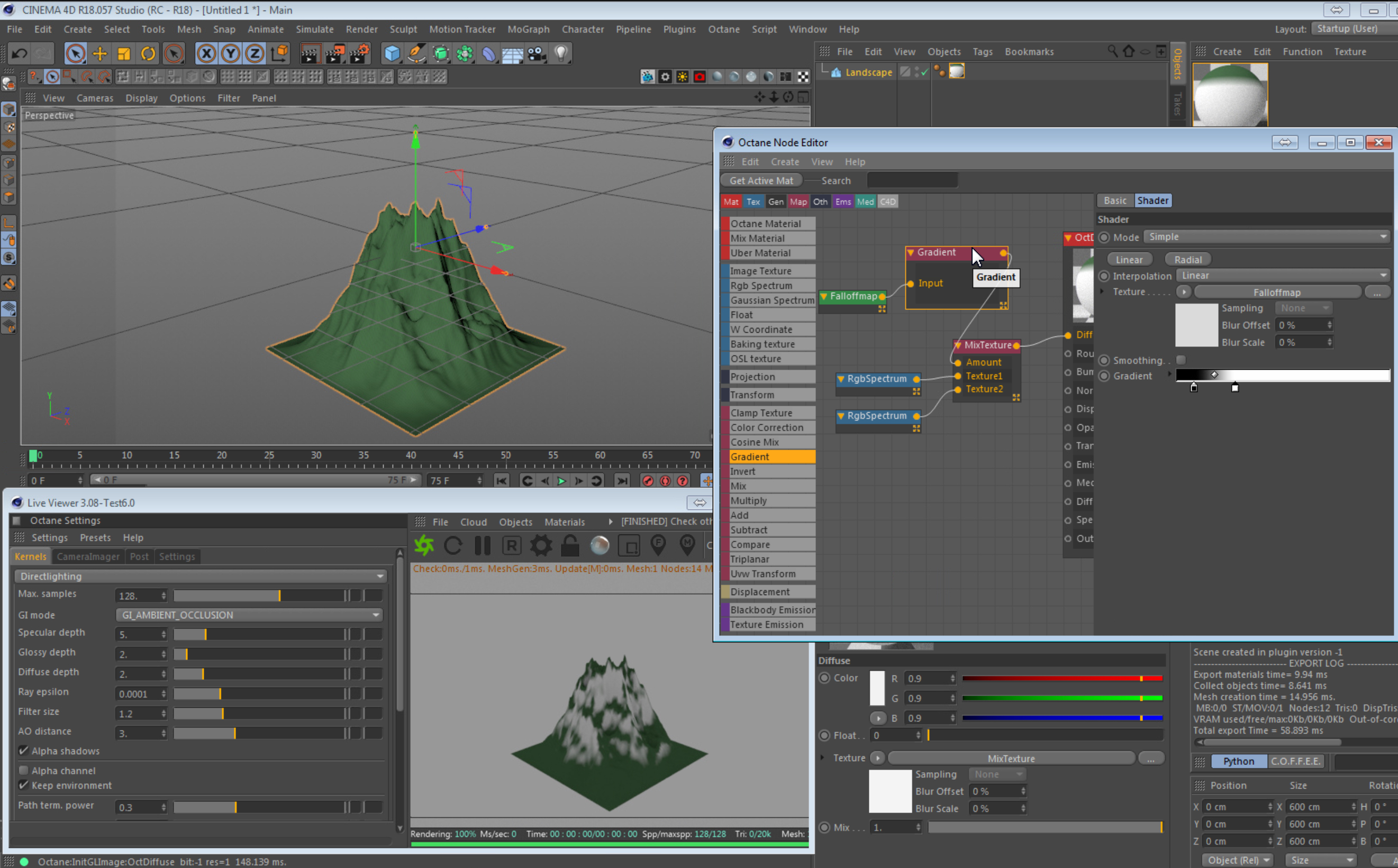

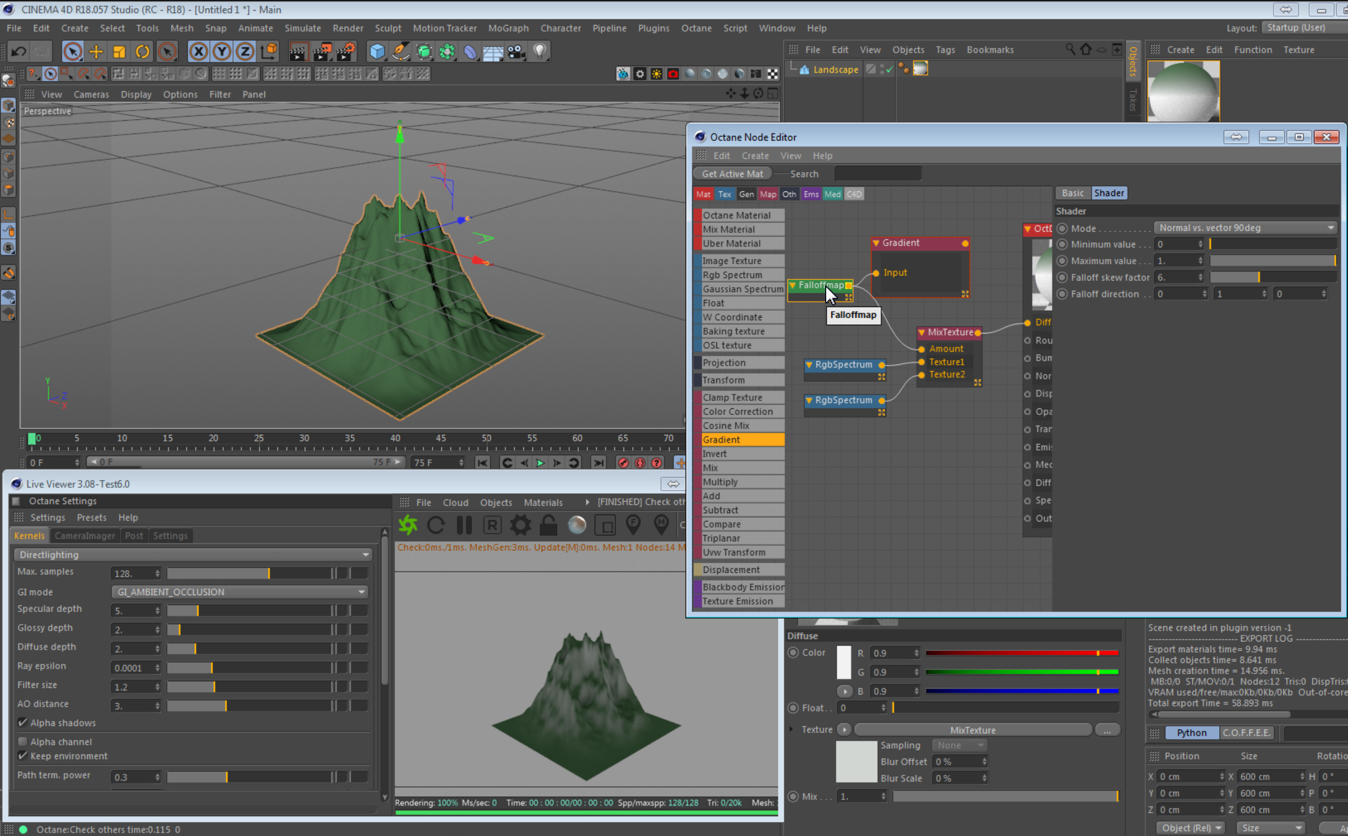

you could use a Falloff texture in "Normal vs vector 90°" mode:
Then use an Octane Gradient Map for coloring based on the height:
