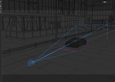

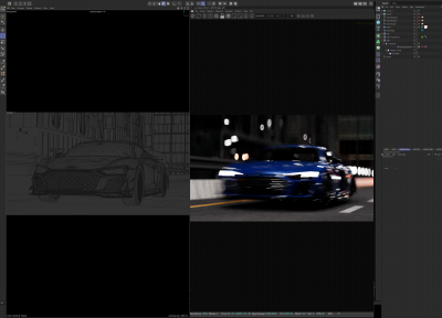

I'm having an issue with motion blur on a moving car not working correctly. The motion blur is being adding to the entire car, not just the wheels and the background.
I have a car model rigged with the Cinema 4D character rigging tool. The octane camera is a child of the car so it moves with it. I applied an octane tag to the car geometry, but the motion blur still appears over the entire car.
What can I do to get the motion blur to look correct (wheel rotation/background moving)? I've tried removing all motion blur and applying motion blur in after effects, but it doesn't look correct.
Screenshots Attached

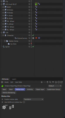

I think that you need to have the Camera as child of the Audi R8 group, now it is in a different group than geometry.
ciao,
Beppe
elsksa
Posts: 784
Joined: Sat Jul 24, 2021 1:06 am
The explanation seems ambiguous.
Without seeing the animation, it is to be assumed that the motion blur works correctly as there may not be any resulting motion blur depending on how camera is animated (tracking, parallax, etc).
Could it be the case?
The rest is as beppe mentioned.

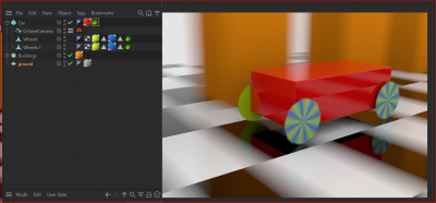

So I found a fix! The camera needed to be parented to the actual car geometry group, like bepe said, not the Cinema4D car rig "body." The wheels needed an octane tag with motion blur set to transform/vertex, and the body geometry (separate from camera) needed an octane tag as well!

While your hierarchy may be deeper and have more branches, the basic structure remains the same. The background objects should blur properly without any special attention.
Also, remember that the Live Viewer isn't designed to accurately produce motion blur. Use the Picture Viewer to check that.
Camera on Car Blur Hierarchy
