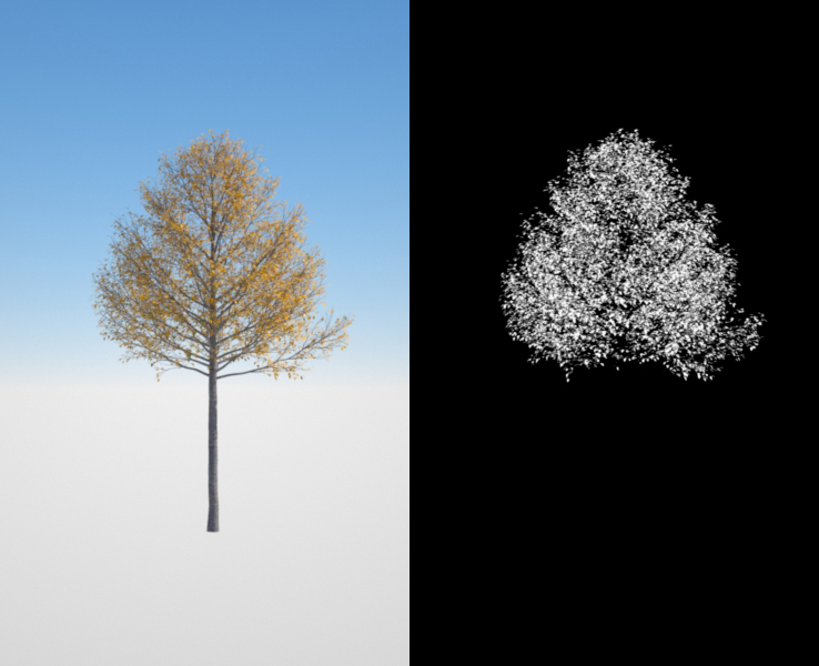

I'm not very familiar with AOVs. And right now I look for something basic.
I use Custom AOVs to create masks.
I would like to know if I can ( and then how ) create a mask for a specified material :
I have a tree ( one mesh ) with multimaterial : trunc, leaves 1, leaves 2 , flowers
I can't use custom AOV to make a mask for the leaves as it is the same mesh.
I would like to render a mask for all the leaves.
Can anybody tell me ? Thanks. :)

I just want to render a mask for the leaves. :-)
paride4331
Posts: 3989
Hi HHbomb,
I hope this is what you needed.
Regards
Paride
mask.mp4
(4.64 MiB) Downloaded 2237 times

Hello Paride,
Maybe i've certainly missundertood something but when i do the same method as in the video, everything works well in the Octane render viewport.
But when i want to render this passes as a Render Elements for render animation, i use "Export Passes Selection to Render Elements" button, nothing happens !
I haven't any passes in the render Elements and when try to add AOV output manually the output stay black.
When i use the legacy AOV output it works but it's tedious.
What is the best practice for this and what I missed ?
Chris
neonZorglub
Posts: 1100
mizterh wrote:Hello Paride,
Chris
Hi mizterh,
This has been fixed in the latest releases (15.06 / 14.12). "Export Passes Selection to Render Elements" should work with AOVs now.
(I forgot to add it in the release posts. I just updated posts of 15.06 / 14.12)
When adding AOV output in Render elements manually, it should work too.. you just need to check / change the 'Parameters' to have the correct AOV number / AOV map name
A black output could happen if the AOV output or one of the sub aov is disabled. but you should see the same thing in the Octane viewport..
Try with 15.06 / 14.12 to see if you still have those issues.
