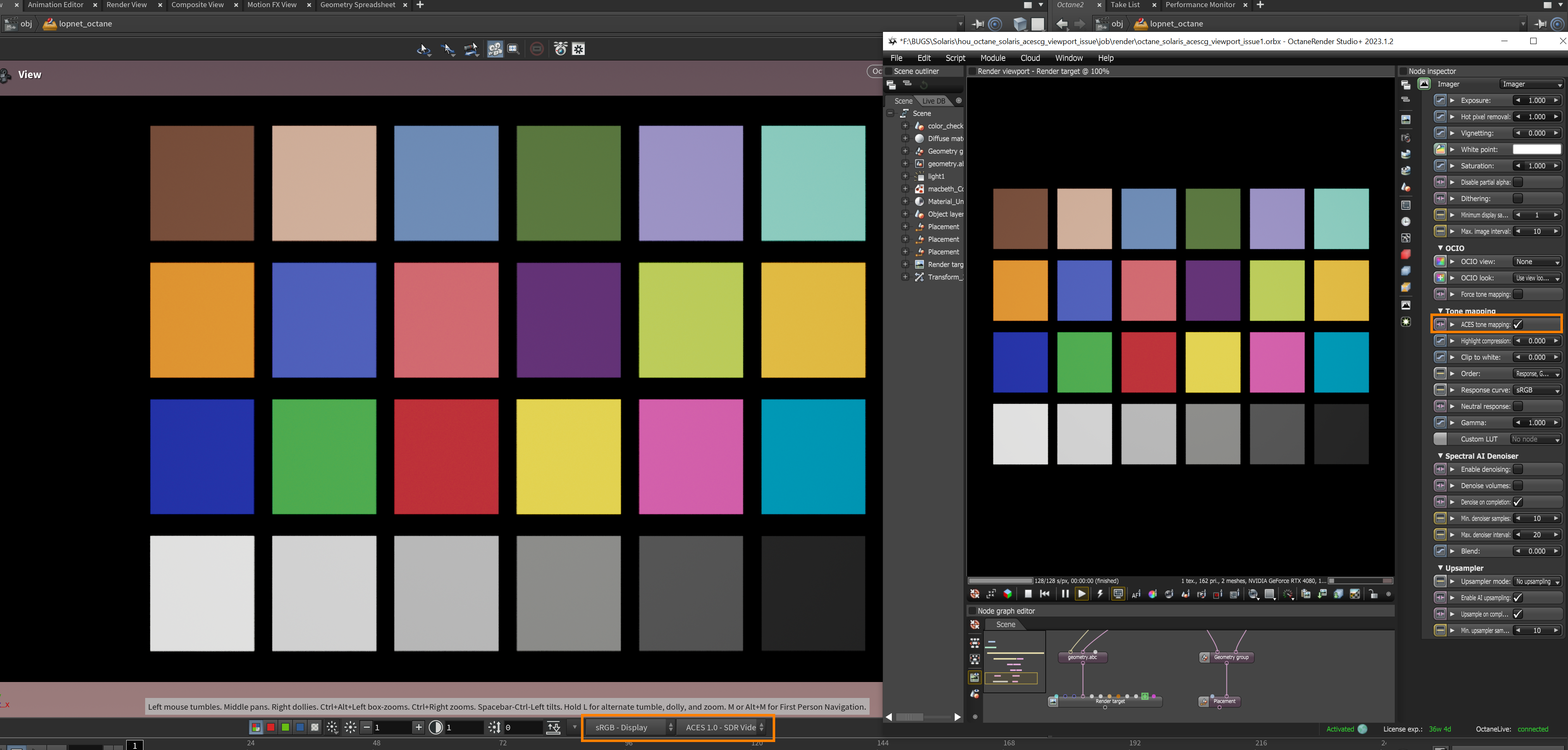

Hi Chris,
Thank you so much for the files.
*does Octane handle this in a different way?*
- Hydra Solaris Viewport render requires a linear image and Aces tonemapped is applied internally. Please enable the Octane Viewport from the tools tab to see the render output.
OctaneSolaris has no control over the Viewport render tone mapping.
*The images in the "output" folder are the rendered images converted from ACEScg to sRGB using the “ACES 1.0 - SDR Video”. Everything matches except for the Octane Solaris viewport.*
- Please note, the *ACES tonemapping* option in Camera>Octane>Imager was not enabled in the file since you were using Octane internal ACEScg.
- We need two step for built-in Acestonemapping,
1. Enable the *ACES tone mapping* option from the Camera node.
and 2. Choose the *Color Space* dropdown from the Octane>output tab for Linear, ACEScg and ACES-2065-1 or OCIO if the .config file are loaded via env.
The render result between Standalone and Solaris seems to be matching!
We are still investigating, please let me know if we missed any steps.
