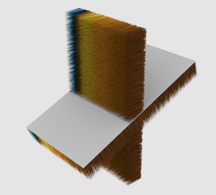

dasmodular wrote:
I also have a problem where hair stays in place and doesn't move, maybe that's related... Please open the attached file, start render and press play.
Not exactly same, but can you show me a picture from the issue?
Hair moves on a plane rotated by an effector and a fracture object, but there is still a duplicate that doesn't move and shouldn't be visible.

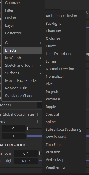

Is there chance to get C4D effects to work in Octane Scatter, like Terrain Mask ? Or Curvature node ?

dasmodular wrote:
It's a different problem, looks like Fracture object have a different behavior with hairs in C4D 2024 version.

It looks like Terrain Mask shader doesn't work even baked.
From C4D Effects Shader tab only Spline works fine in Octane. Interesting why others doesn't work here.
