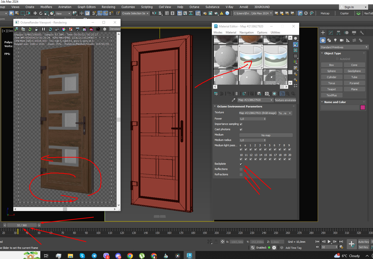

Adding HDR causes scenes to crash, especially when the scene is animated

Hi Elvissuperstar007,Elvissuperstar007 wrote:Adding HDR causes scenes to crash, especially when the scene is animated
Nvidia 4090
Intel Xeon e5 2690v0
64gb DDR 3 1866
Windows 10
Thank you for reporting this issue.
I think I could reproduce it.
It seems caused by a wrong update when the Texture environment map is selected in the material editor while dragging the timeline.
This should be fixed in the next release.
For now, the work around is to select another texture in the material editor when dragging the timeline.. sorry about that !
But the best solution is to move the 'Texture environment' to a Daylight object.
It internally creates the same Texture environment, and gives the option to setup the 3dsMax viewport to have a display that matches the Octane render :
Improved support of Environment maps
viewtopic.php?f=27&t=78198
(basically, from Render settings / Support tab / Environment : click on the Help button, and select "Create Octane daylight ..")
