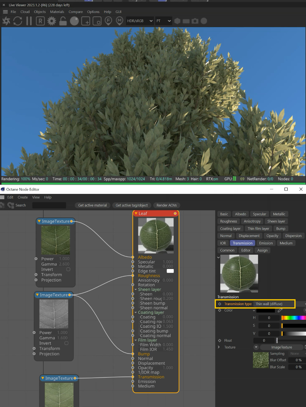

But for leaves and grass, my suggestion is to use an Universal material, to be able to work with one single material with all the necessary characteristics, and in this way, you can change the Transmission type to "Thin Wall Diffuse", perfect for leaves and grass blades:
