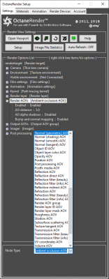

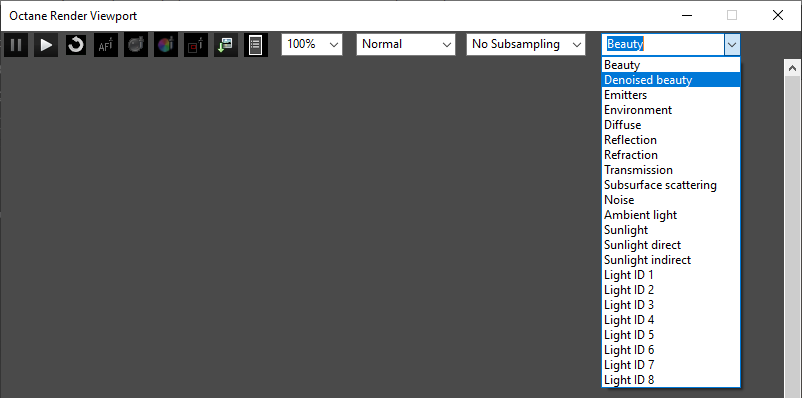

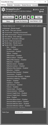

Silly question maybe ...
In previous versions there was an option, to set the "Render AOVs" to "Render passes" and in there, enable/disable the passes we wanted to get over into in the "Viewport" (or not).
(The long list of render passes, we could choose from)
and in the Viewport, using the drop down, to display them there
In newer versions this might have changed, as there isn't a "Render passes" option anymore.
I might have overseen it, but is there a way, I can get all the passes, I want to see, back into the Viewports drop down menu again, please?
Thanks.

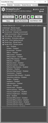

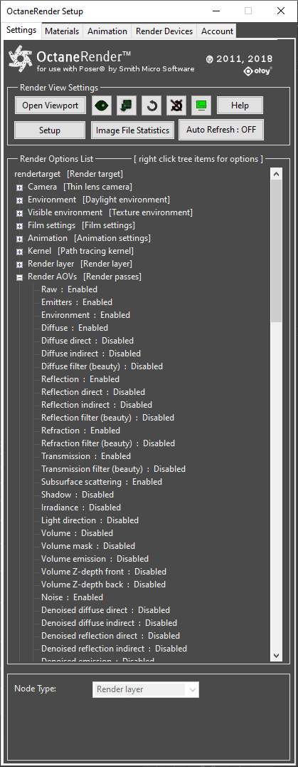

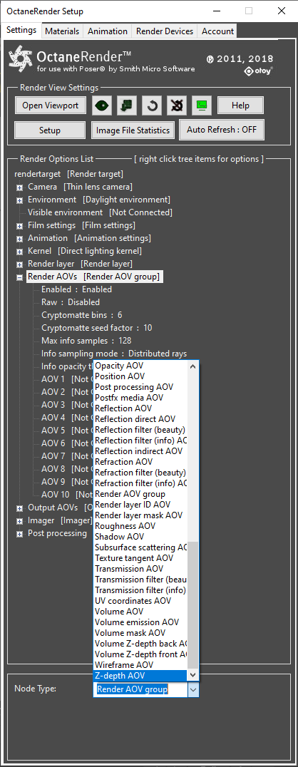

Hi Paul,
thanks for having a look.
The other installer for 2023.1.2.122 didn't change anything for me.
I think I noticed this behavior quite a while back already, but forgot about it, as I at one point exported the rendertarget setting I once used (as a *.por file) from an old scene and re-using it ever since (still today).
So, when with todays version, I import the old rendertarget settings (the *.por file), the Render AOVs - Render Passes, are showing up again.

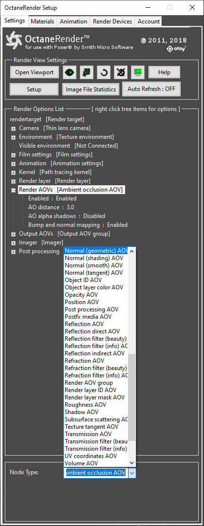

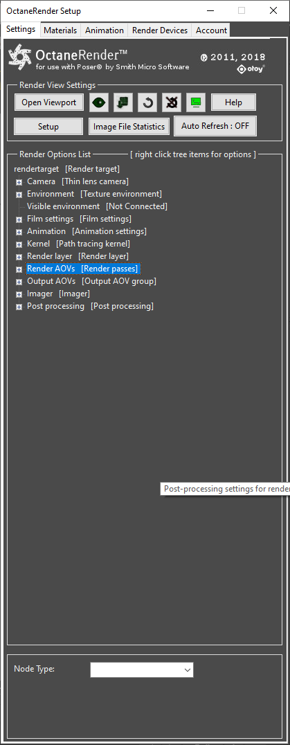

Switching to a different Render AOV (like Ambient Occlusion AOV, Baking AOV ..etc ..) and then wanting to go back to the "Render Passes", it's gone again from the menu.
After the import of the old settings (*.por file) into the latest version (2023.1.2.122:
Switching back and forth between the Render AOVs: Render Passes are gone again:
Maybe at one point, the OR devs switched up this system, and I just didn't catch it =D

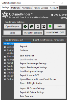

If you rightclick the rendertarget and "Load from Default" does it fix the issue?
Paul
Erick
Posts: 249
Joined: Thu Sep 13, 2012 9:40 am
Paul
I can't, as it's greyed out for me. Looks like I don't have a default RT file.
Saving a default file is possible.

I understand. I think this version should resolve the issue. Can you please confirm?
https://render.otoy.com/customerdownloa ... STUDIO.exe
Paul
Erick
Posts: 249
face_off wrote:I understand. I think this version should resolve the issue. Can you please confirm?
Paul
Looking good so far.
Render AOVs -> Render passes are all visible again.
Thank you for the support! :)
