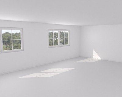

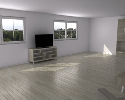

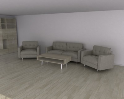

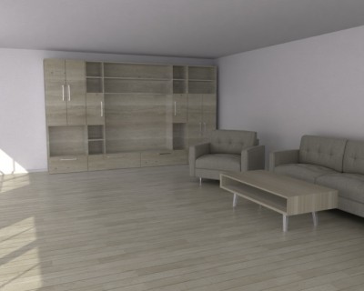

Here are my Renders. 6 Lighting Groups/Octane Tags.
Like real life camera you should try to increase exposure if camera have window on its back side. Also like in real world - light power outside window is really very strong compared to inside room : Try to highly increase it and you will get more brightness inside. And again if camera is looking towards window decrease exposure. This auto-exposure function can be driven by xpresso in relation to camera angle rotation. It is good to have high highlights compensation or use OCIO like AgX.Conna3005 wrote: If you know a Technique how to set the Light for the whole Room give me a Hint.
