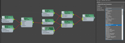

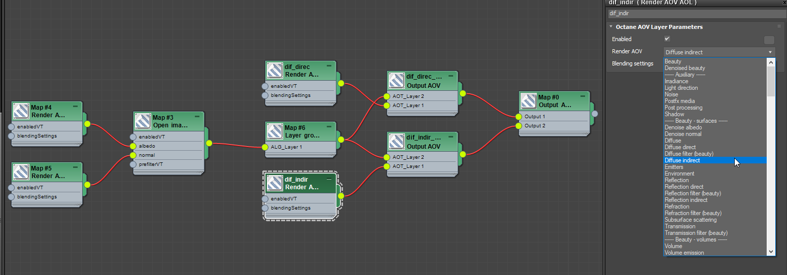

HHbomb wrote:Hi,
"Denoise diffuse indirect" pass don't work with Open image denoiser ??? It works with Octane Ai denoiser.
Normal or a bug ? :(
Thanks.
Hi HHbomb,
Thank you for reporting this issue.
I'll check with the engine team. Maybe they missed it, or we may need to use the new AOV system for this:
As demonstrated in the sample from the paragraph "Powerful Denoise AOV Nodes and Filter Graphs (GPU and CPU)"
in the What's New in Octane 2024.1 Alpha 1 post:
viewtopic.php?f=33&t=82267#p427823
Open AI denoiser can in fact denoise any pass, any AOV.
Here is a small sample with AOV1 denoising Diffuse direct pass, and AOV2 denoising Diffuse indirect.
Change the pass in the layer 1 to any pass, and it will be denoised ! ;)
openDenoiser07_diffuse_indirect_mx20.zip
(82.34 KiB) Downloaded 108 times
HHbomb
Posts: 1433
Ok ! make sens :-)
I'll try to deep inside ! Thanks.
ps : but if it can create denoise directly as AI denoiser, I'll be happy too !!!
