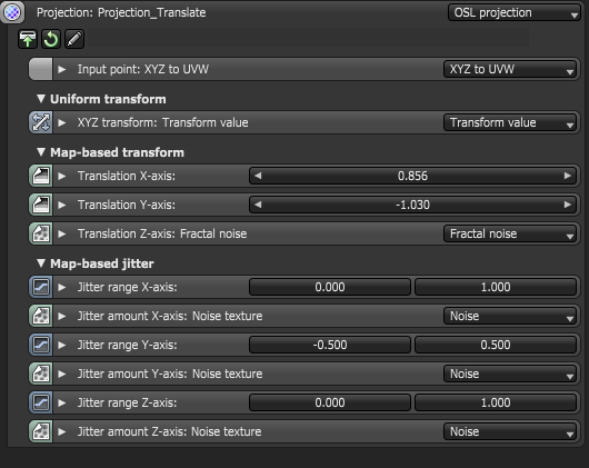

As these have more controls over the transformations I split them into 3 separate nodes for rotation, scaling and translation.
Each node supports three types of operation: uniform transform, map-based transform and map-based jitter. Jitter randomizes within a range with the jitter value driven by a map (expected in [0..1] in this case).
They also all have a projection input, so you can daisy-chain them.
Unlike distort UV, each axis gets its own map, and the maps are expected to be grayscale (typically either a single number or a noise). This way we don't have to build a color map with other nodes or use channel split/merge just to translate on one axis for example.
For scale there are also controls that work on all 3 axes at once.

Example of the node interface:

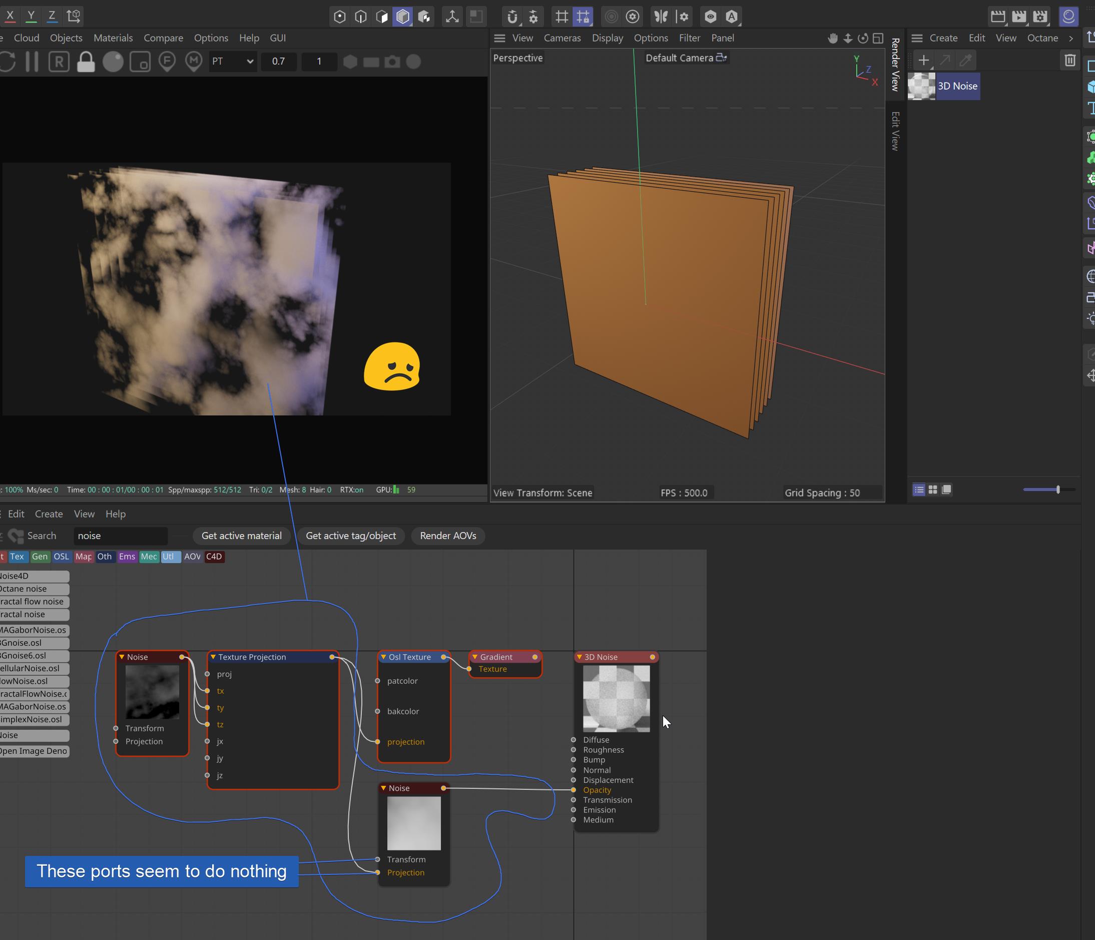

This is using the OSL based C4D noise (only version I believe that is working in 3D world space) but the projection port does nothing.

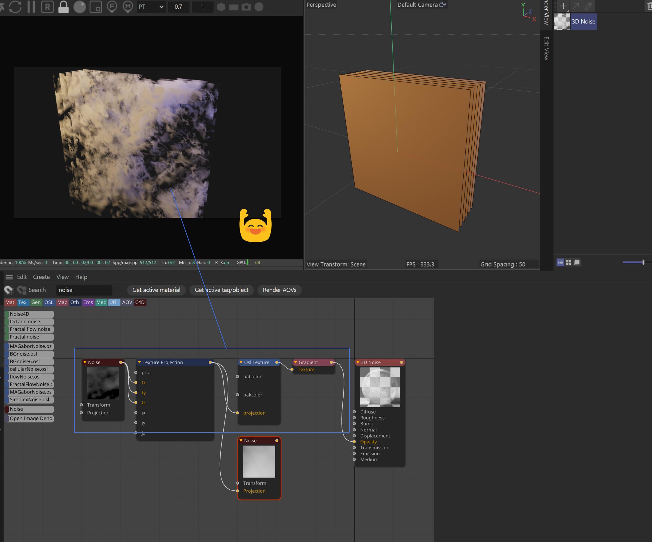

In this shot I'm using an OSL based flow noise that is being distorted or "translated" by one of your wonderful OSL shaders and this is working great! I just don't know why the OSL C4D noise ports do not work.

Most likely this implementation of the C4D noise hard coded the use of the `P` global for the input point instead of using the variable from the projection pin.
If you plug one of the built-in projection like XYZ to UVW or Box and change its transform it's not working either?
