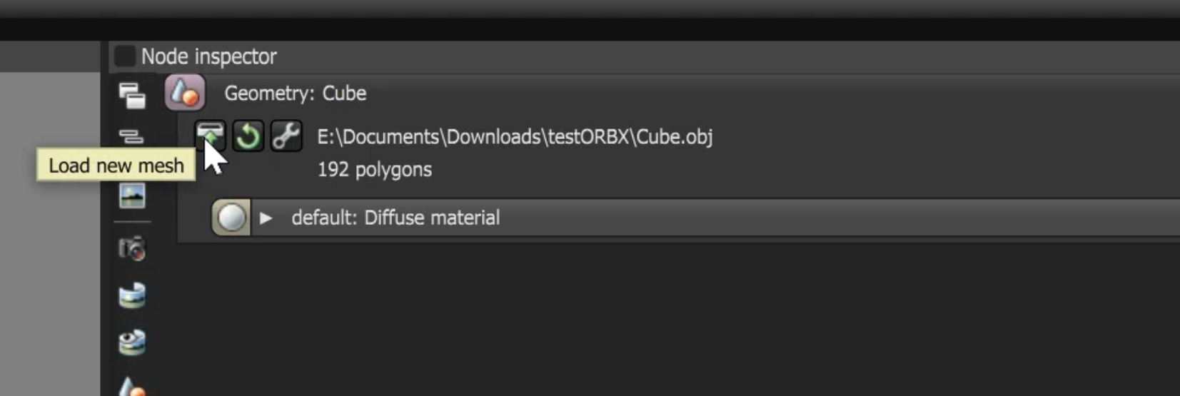

have you tried to use the "Load new mesh" command, instead of "Reload mesh"?
