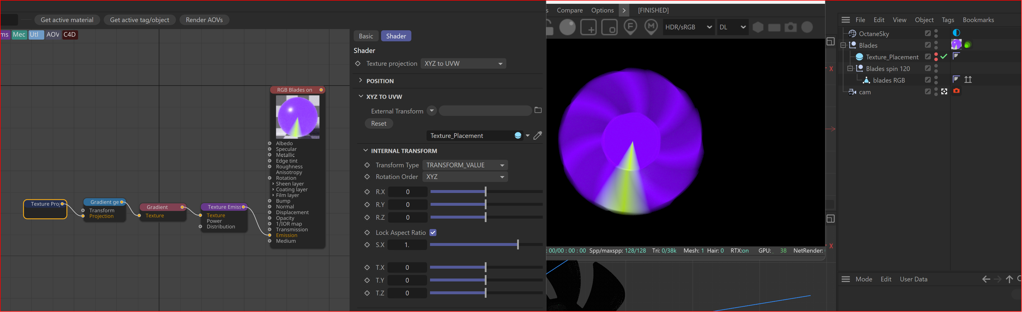

It's not the motion blur "breaking" it. It's blurring exactly the way I would expect it to with UV mapping. The way you have constructed your Octane shader, it has no Octane native texture projection info. Without that, Octane is defaulting to UV mapping. If I understand what you are trying to do, you want the texture space to be associated with the Null farther up the hierarchy so that it does not spin with the geometry and so that the texture remains stationary relative to that Null. To do that, you need to give Octane some more info.
You are currently driving Emission with an OSL Gradient utility node, which isn't really a texture, so it doesn't have texture Projection inputs. Instead of using a Baking node with an OSL Gradient to get access to Projections, you could use a Gradient Generator node, which has its own Projection input. An Octane Gradient Generator node generates float data, though, not RGB, so you need a standard Octane color Gradient node to colorize it. Here is an example.
In this case, I'm using a hidden sphere as my External Transform object for clarity's sake, but it could just as well be the Blades Null or any other object in XYZ space. With this hierarchy you can move Blades Null anywhere you want, and the texture will remain still, relative to it, since the External Transform object is a child of the Blades Null.

But im not using uv mapping, im using a static flat projection attached to the null. My setup does fundamentally work, the texture projects correctly and remains attached to the parent null as the object inside spins, the motion blur system however only seems to be assessing the flat projection of the texture on the first frame and then simply assumes it must be rotating around with the fan blade on subsequent subframes. Honestly, this is just coming across as a missing refresh somewhere.
