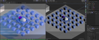

As far as I can tell there still isn't a working solution for "zooming" in and out using an orthographic octane camera that will match what you see in the viewport.
If you zoom using the "zoom" parameter, it will match the viewport, but at a certain point the scale changes, ie as you pull back, the octane render will be increasingly further zoomed out than what you're seeing in the viewport.
If you keep your zoom at 1 and use the "focus distance" parameter to push in and pull out, the viewport doesn't change.
The attached still shows the discrepancy when using "zoom" to pull out.

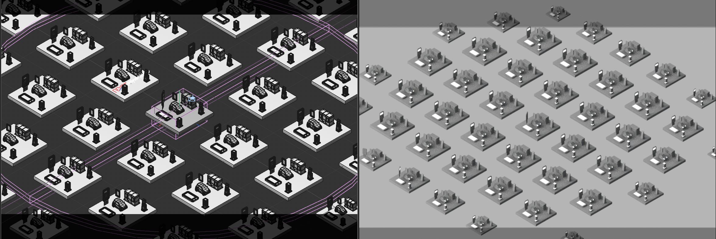

You can clearly see it doesn't. I had this problem 2 1/2 years ago and it's a pitty it's still a problem. In every other engine/DCC this just works.
viewtopic.php?f=30&t=77384&hilit=isometric
If you need pixel perfect animation, octane's solution just doesn't work.

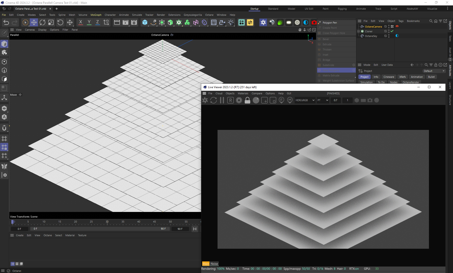

I just tested the new build, but I'm not sure about the correct use to get the same viewport and live viewer/picture viewer result.
What I did here in the attached test file was:
- Create an Octane Camera
- Switch to "projection: parallel" under camera object properties
- Turn on "orthographic" under the Octane Camera tag Thinlens tab
Is that the intended use? I still get a mismatch between viewport and Octanes render. Or do I misunderstand something?
